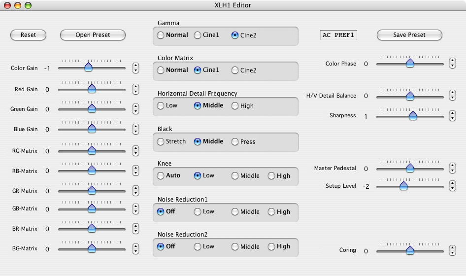

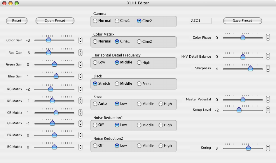

Attached is a screen shot of the settings that I came up with, and Alister Chapmans settings for CP #1 in the library.

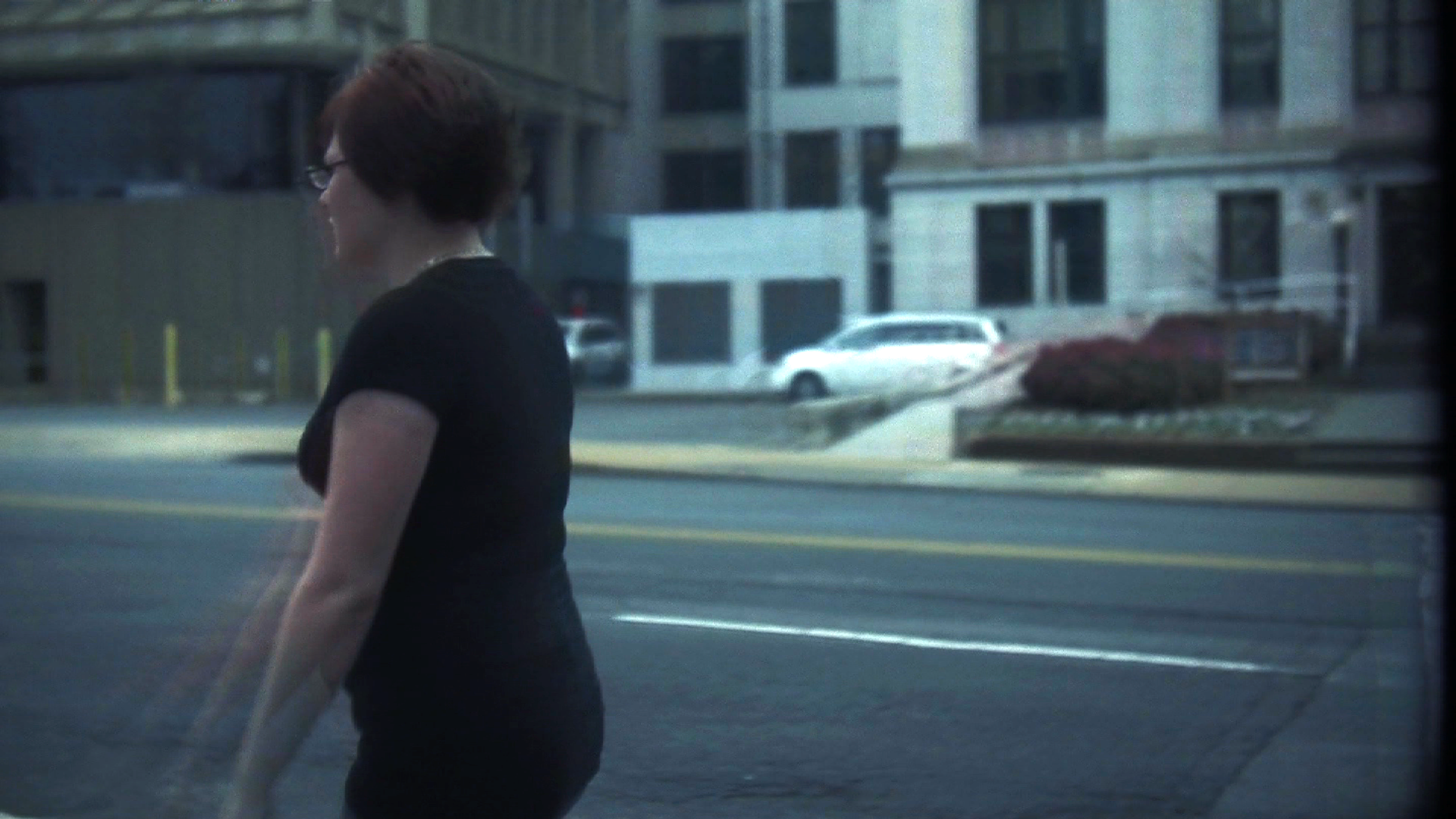

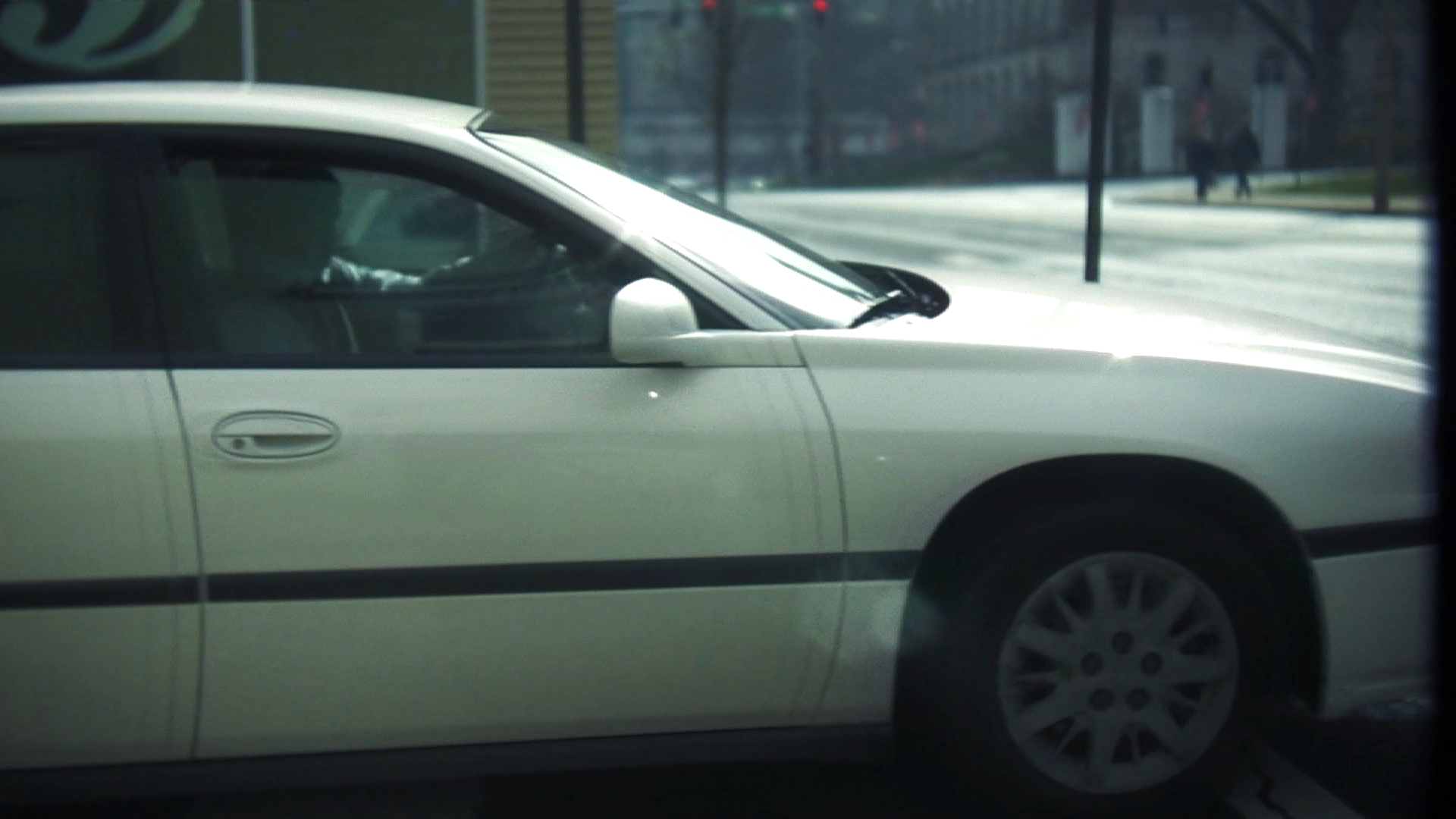

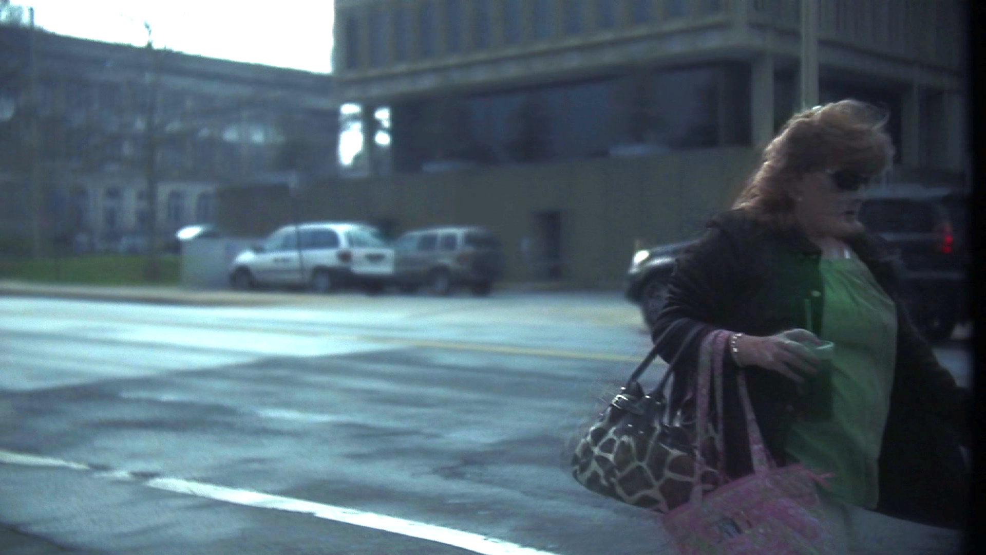

Thanks Peter and Daniel. I'm working on some new presets without NR1 and will let you know what happens. In the mean time, I've posted some screen shots and video clips at www.cartermedia.tv/DVinfo_samples
The movie clips are HDV 24p out of FCP Studio 2. The footage was shot in 24f using a Redrock Micro with a Nikon Nikkor S 50mm set at f2.
Camera settings:
Sequence_3_dp.mov and Sequence_3_dp2.mov - AE Shift 0, shutter 1/100, exposure locked and then +1
Sequence_3_dp3.mov - same as above but with shutter at 1/60 and AE Shift +.5
The ghosting is very apparent in red highlights and people's faces. The faces look like they are melting off. Kind of like Tom Cruise's face when he takes that shot in Minority Report. Also notice ghosting in the arm in Sequence_3_dp3.png.

Turn off Noise Reduction 1.
This will cause ghosting in low-light conditions.
Do not use Noise Reduction 1 unless you are locked down on a tripod. It is even better to avoid this at all times.
