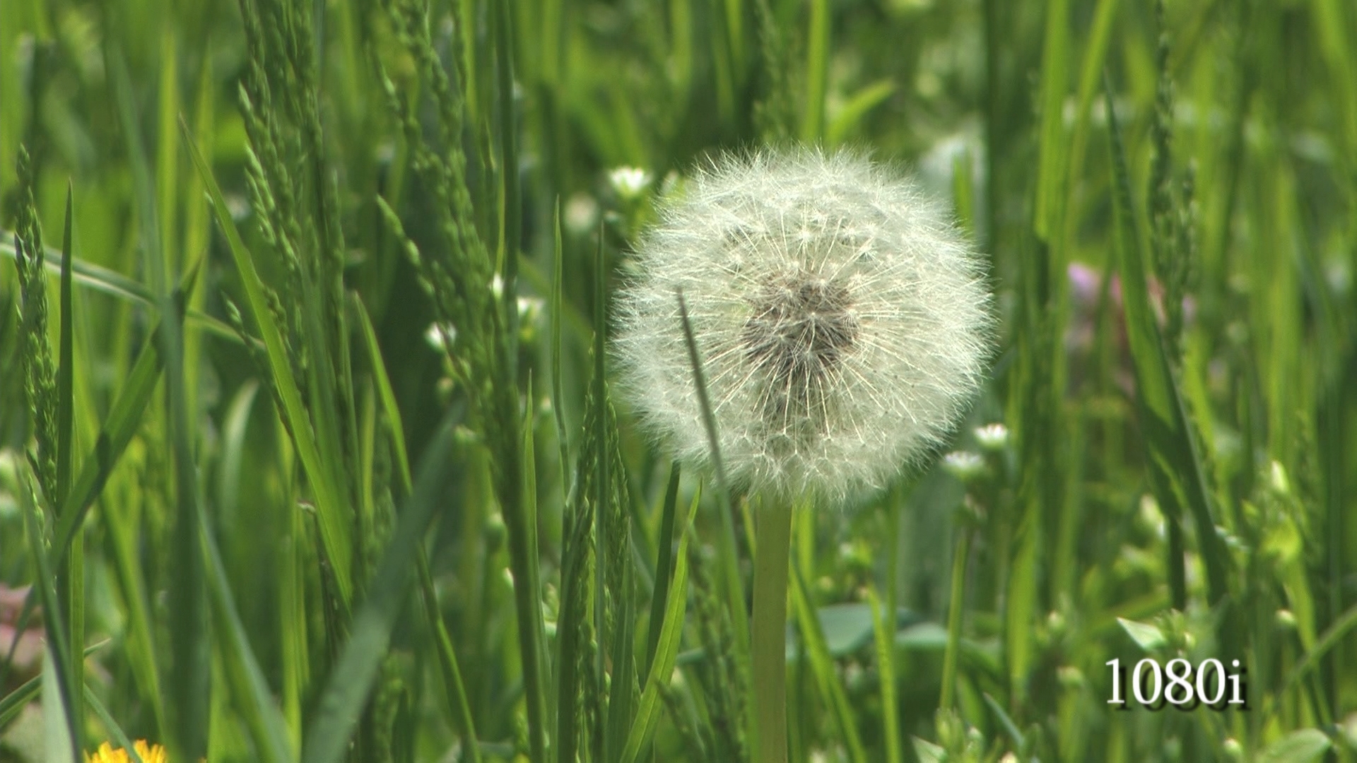

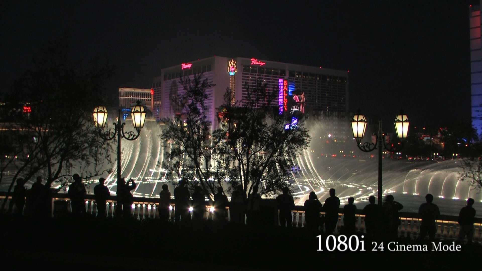

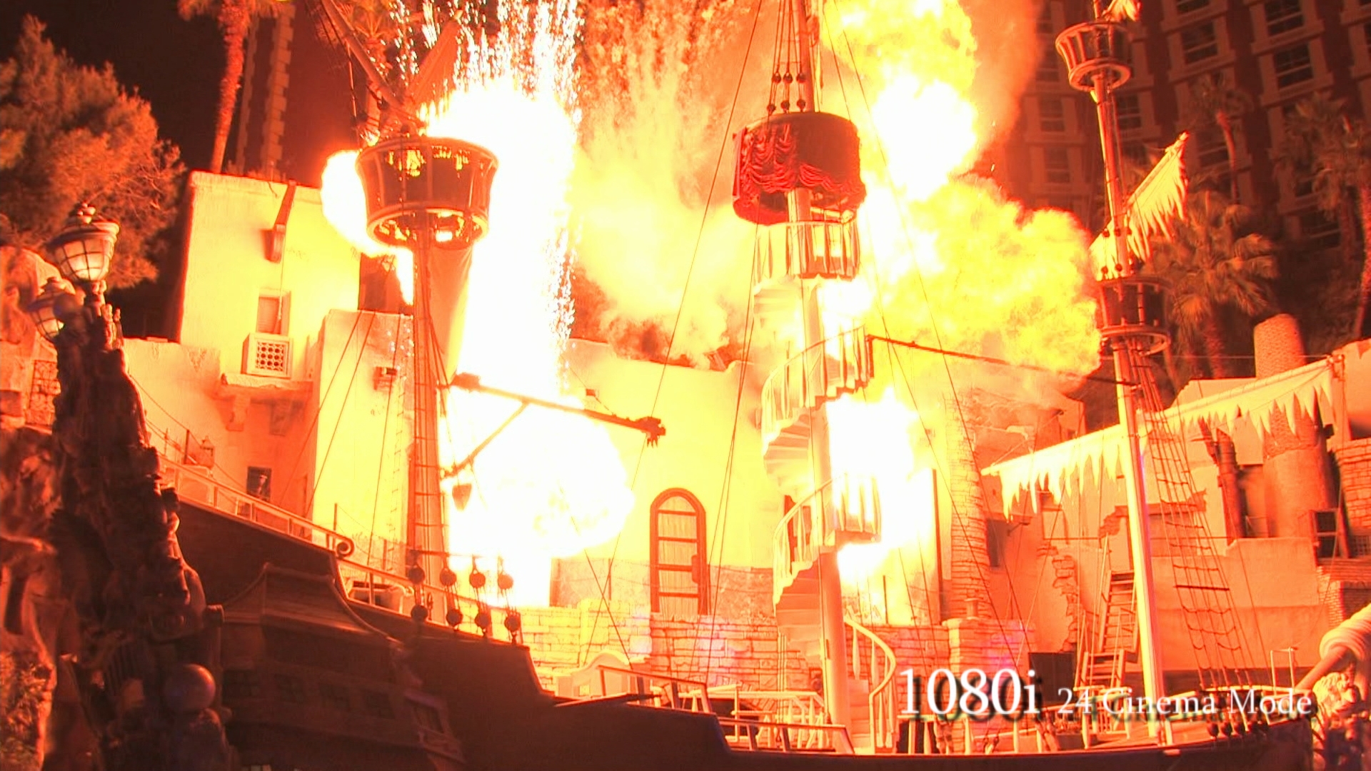

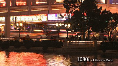

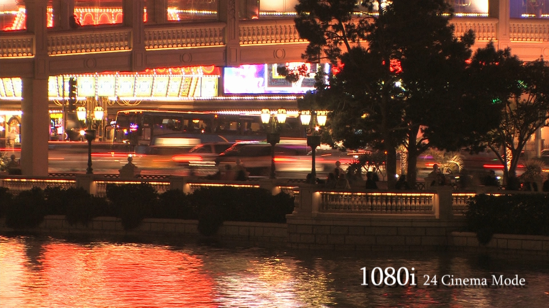

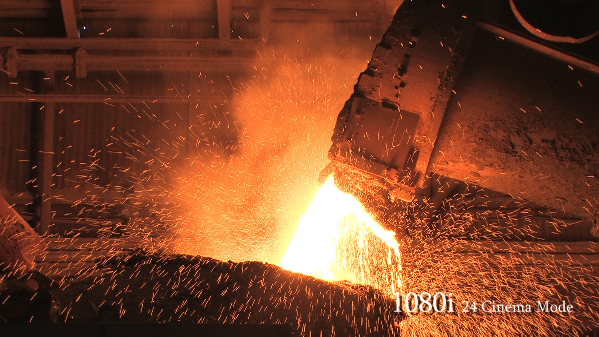

Since it seems this topic got "opened" again...
I wanted to do what I had promised....
I've re-compressed the footage and posted it as a WMV HD file...
The link that started this topic is the same....
Paste this into your browser:
ftp://68.83.117.113
user: canondemo
password: xlh1
Drag the movie to your desktop...
I've attached some jpgs so you can see what some of the images are.
ENJOY !
