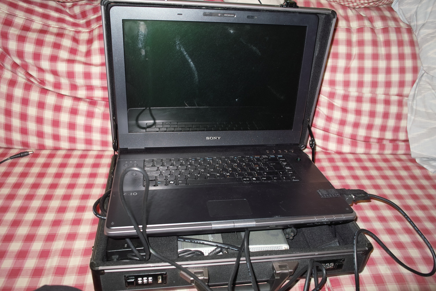

Old May 28th, 2008, 03:48 PM   #5
Join Date: Oct 2007
Location: London
Posts: 201
Alex
Here ya go
Magma + Intensity Pro + Laptop: which laptop?-sdim0209.jpg
Henry Olonga is offline   Reply With Quote
