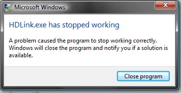

So is the problem I am having because of the licensing issue? I do have COREAVC pro version 1.9 installed with Mediasplitter and HDLink crashes. Does an earlier version of COREAVC work?

No, you using CoreAVC that is a different component, not what we are licensing. CoreAVC works in 95% of systems, it seems like the 5% can't resolve some other system conflicts. One of the reason we are adding a AVC decoder to version 4, so we don't have these system conflicts, add we can features with fewer support issues.

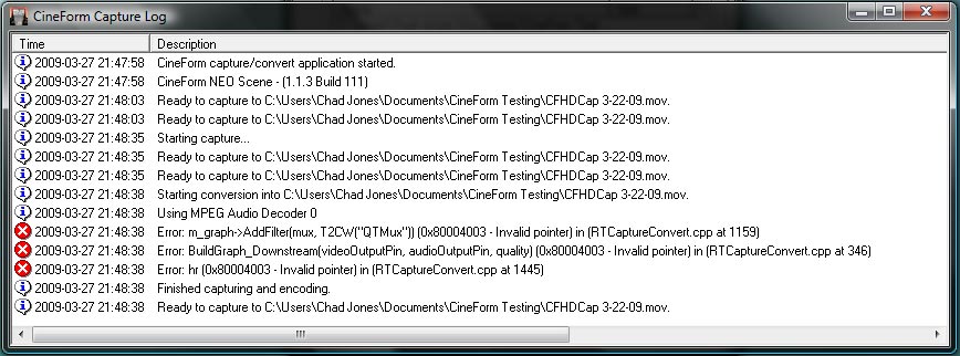

Location: Keller, Texas
Posts: 23
Neo Scene Capture and Conversion Problems with Vista?
I've been trying to evaluate Neo Scene, for a couple of updates now, on my Vista 64 bit system. So far, I have not been able to get it to work. I evaluated a version of Aspect prior to this attempt, which was un-installed before the installation of Neo Scene. I've attached some screen shots below of what happening. When I try to convert a 5d mark ii file, Neo Scene quits giving me the "HD Link.exe has stopped working" message. When I try to capture HDV footage, the application begins to capture and then immediately stops giving me the "invalid pointer" error. Does anyone have any suggestions to fix this problem?
Chad Jones
Here are my system specs:
Dell Core i7 920
Vista 64 bit
4 GB Ram
Radeon 4850
CS4
Neo Scene -- various topics-neo-scene-capture-log-3-37-09_2.jpg   Neo Scene -- various topics-neo-scene-convert-error-3-37-09_2.jpg

What exactly is qtmux? It looks like something that was part of a software or codec package that you installed. Try uninstalling it. Or run GSpot and see what you can find out about qtmux.

Location: Solana Beach, California
Posts: 6,525
Sound like there may have been an old Aspect HD setting that is throwing off Neo Scene. You should not be using QTMux, with is for producing MOVs on the output.
Try this:
1) Uninstall Neo Scene.
2) Open RegEdit
3) Delete everything in HKEY_CURRENT_USER/Software/CineForm
4) Reinstall Neo Scene
5) Try again.
David Newman -- web: www.cineform.com
