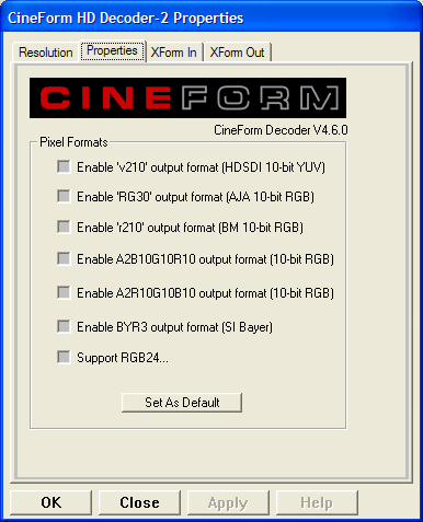

AVIs do not have any such limitations, they are just a container, no different that MOVs. There are Microsoft pixel formats that support 10-bit RGB that our AVIs will use (examples formats are A2B10G10R10 and A2R10G10B10 used under DirectX under VMR-9.) 10-bit YUV formats like 'v210' also are supported, and will play directly out Blackmagic and AJA DirectShow interfaces. See attached picture of the DirectShow control panel for out decoder (6 of 7 seven formats listed are 10-bits or more, even within NEO Scene.) Your little bird is equating AVI with Video for Windows, which it shouldn't be, under DirectShow there are no pixel format limations (we currently support a dozen or so deep pixel formats throught DirectShow, without customer importers/exporters.) Second issue, I don't think that Vegas using the deep pixel mode with QuickTime/MOV either, otherwise we would support that on our high-end tools, if this has been fixed we can add MOV easily. Third issue the API for file I/O is something we have been asking for, while I think Sony is close (can't tell you the details) we couldn't provide deep I/O in Vegas today anyway. So in is not a CineForm issue, I'm not sure Vegas supports any deep I/O today, that is not say the 32-bit processing mode doesn't have value, it does, just you can't leverage deep sources (RAW source need it.)
So why 10-bit? Now storing an 8-bit HDV/AVCHD in a 10-bit uncompressed format is a waste of bits (8-bit uncompressed is sufficient,) however storing as 10-bit compressed is not, as we have found that the 10-bit internal representation improves PSNR numbers even if I/O bit depth is limited to 8-bit. If we could output deep in Vegas the 8 to 10-bit compression does smooth out some of contouring, this is one of those cases when compression is good for quality reasons. Next is your assumption that 10-bit compressed takes more storage than 8-bit compressed, is so marginal it becomes insignicant, plus clean 10-bit sources stored as 8-bit can be larger than native 10-bit compression (aliased gradients are harder to compress than smooth ones.) Also there is the YUV to RGB factor I mentioned in the previous post, another reason to want the higher internal precision. So we stopped try to maintain 8-bit compression technology just as marketing seperater. The same codec core is used around our entire product line, the price difference is about the surrounding tools more that the compression.
