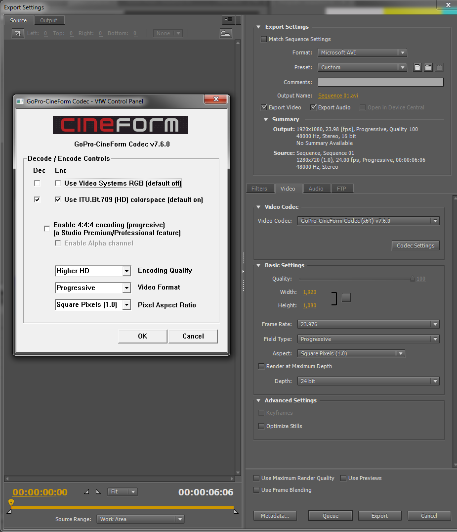

Posts: 8,095
Re: Neo First Light
something like this
Old January 3rd, 2012, 08:08 PM   #15
Location: Los Angeles, USA
Posts: 2,114
Re: Neo First Light
David, thanks for the visual. I created a preset for now.
So what's the difference between why this way will export the file much faster?
