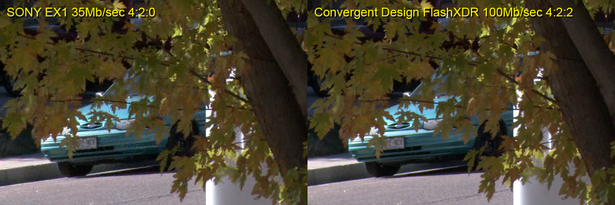

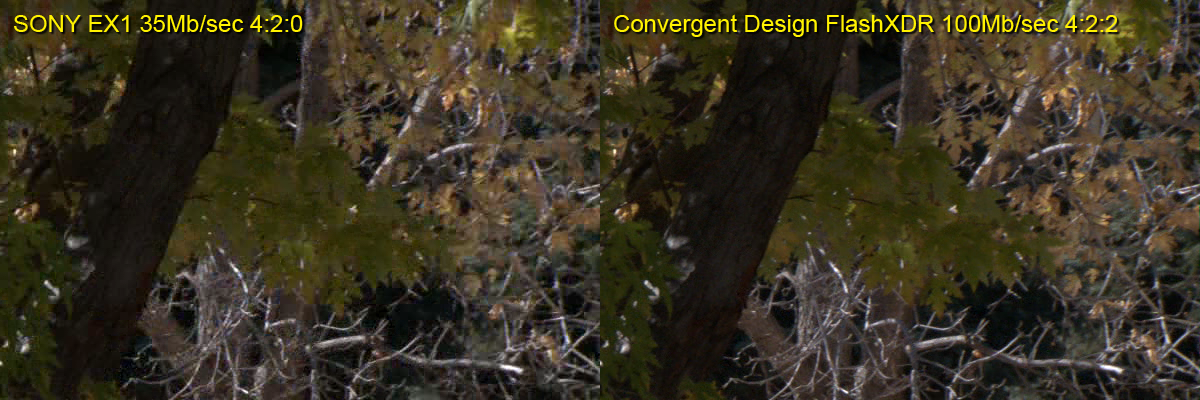

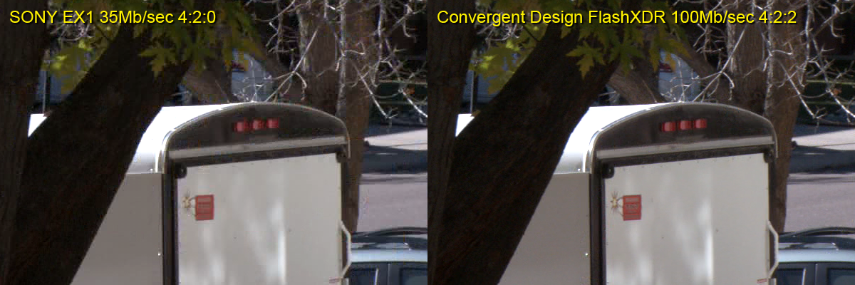

35Mbps 4:2:0 vs 100Mbps 4:2:2 Comparison
Here's some great comparison shots courtesy of Jim Arthurs. The video was simultaneously captured on his Sony EX1 using the internal 35 Mbps CODEC in HQ mode and externally via HD-SDI into the Flash XDR. The Flash XDR CODEC was set to full-raster 1920x1080 4:2:2 Long-GOP at 100Mbps.
The images were taken from a horizontal pan with a very high speed shutter setting to eliminate blur.
Zoom in and you will clearly see the differences. The 100 Mbps is virtually 100% free of any compression artifacts.
IMO, the 4:2:2 Long-GOP format holds up extremely well at 100Mbps, even in high-motion scenes and is virtually indistinguishable from uncompressed.

Thanks for the shots Jim & Mike.
There is quite a bit of difference between the two sides.
Almost to the point that it looks like two different cameras from a detail and color depth point of view.
One can see the 35Mbps 4:2:0 filling in areas with grey while the 100Mbps 4:2:2 side has solid color information.
