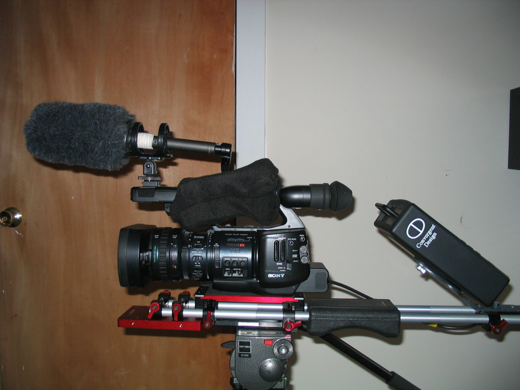

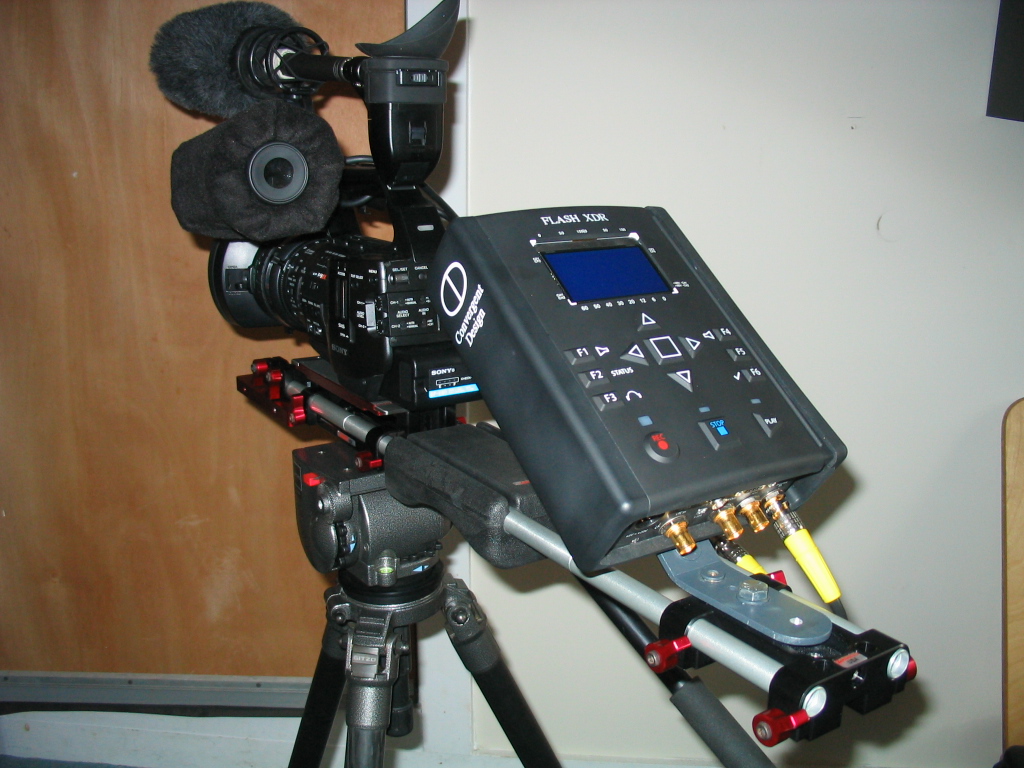

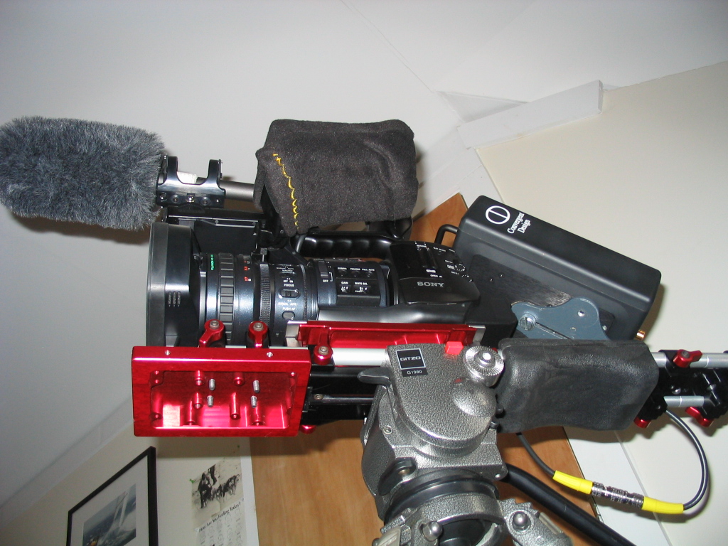

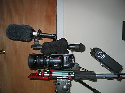

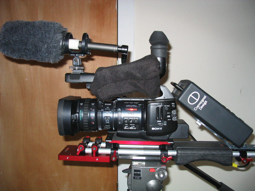

Wow loads of emails asking about my set up. The battery and cards are not here yet but this is what I have now.
Solved the mounting of the Flash XDR on my Zacuto rails. The system works very well and can be adjusted for my three needs. The Anton Bauer Diconic 90 battery will go under the lens up front to help balance the rig. And the XDR can move forward when on the tripod and Heli gyro rig. Then when it needs to be hand held I slide it back and the LCD with viewfinder options works perfect. I was able to simulate the battery weight and the rig balances perfect. It is a lot lighter then my hand held two-gyro rig.

Thanks for the photos - nice job of mounting.
You also addressed the prevention of wearing out the SDI ports on the XDR and EX1 by placing a coupler between the camera and XDR as Mike Schell suggested. Can you supply more details on your SDI cable setup.

John, Dan Keaton built the cables with the coupler it gives me options and he did a very nice job on all of the cables.
Jeff that could be true but it is nice to have the options if I connect and disconnect when the XDR is left on the rails.
