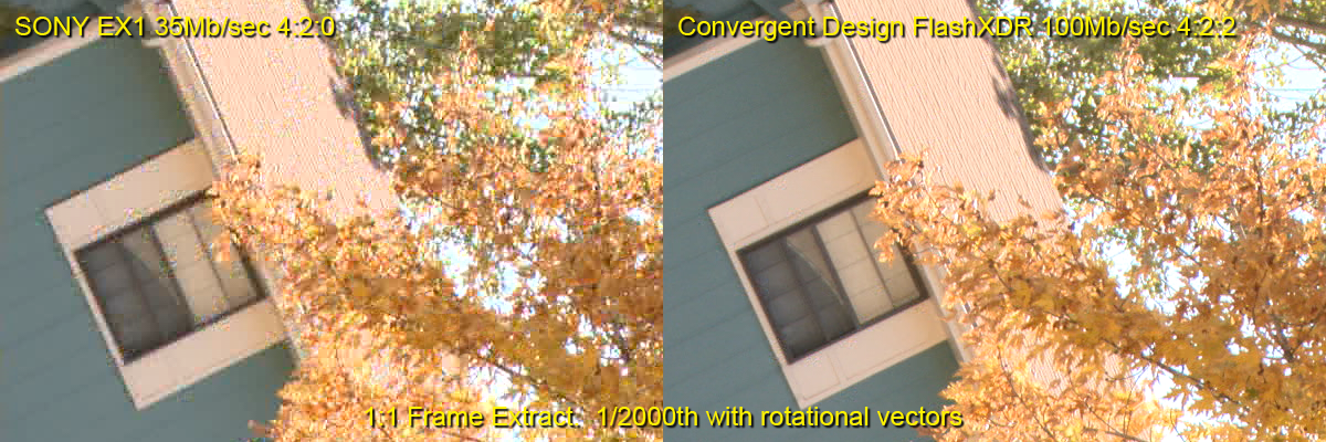

Dear Paul,
What a coincidence!
We have already shot those exact scenes.
We have the grinder footage on a CompactFlash card and show it at trade shows. It looks just great. (Sorry, but I do not have a frame capture at this moment to post.)
Jim Arthurs performed a torture test of the EX1 and the nanoFlash simultaneously by doing exactly what you suggested.
NFL Films using NanoFlash-ex1-35mbps-vs-100mbps-long-gop-camera-rotation-2.png
