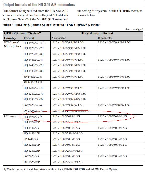

With no S-log I use the nanoflash on the Dual link A output which has only a 1.5G 422-video setting. So then I can use the SDI/HDMI/Video out simultaniously for monitoring purposes in any format I want without disturbing the recording to the NF. I assumed that this output is exactly the same as the standard HDSDI output of the camera, with all the picture(profile) settings.
Is that right? I didn't notice any difference between the HDSDI and the DUAL Link A out.
The manual says that on 50i the output wil be 1920/1080 50P. And although I have the camera system settings on 25P it is outputting a signal (25P)
That is correct, when the F3 is NOT in S-Log mode the SDI A and B ports AND the Monitor ports will follow the same picture profile settings.
