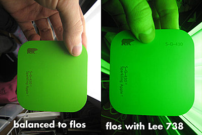

I went to Home Depot today and picked up all the saturated green paint chips they had. I brought them home, and shot them under neutral lights, as well as the Lee 738 filter I described in this thread:
http://dvinfo.net/conf/showthread.php?t=109135
The winner was Behr S-G-430 ("Sparkling Apple"). When shot with controlled lighting and perfect white balance (using a Macbeth ColorChecker as reference), it put out a bright Green signal with low and well-balanced Blue and Red components. The other chips all had uneven amounts of R&B, or low G output, etc.
If you check out the attached image, you'll see two shots, one taken with bare fluorescents, and one taken with them gelled with 738. You can see that in the white-light image, the chip reflects a nice healthy green. When shot under the Lee 738, it reflects a near-perfect green (unsurprising, since Lee 738 is such a great green filter that just about anything shot under it reflects pure green).
I also picked up a 8'9" x 11'9" canvas drop cloth while I was at Home Depot... Next time, I'm picking up some green-tinted primer and Sparkling Apple so I can paint my own DIY greenscreen background!

I just copied that into Photoshop. In the green-lit image, I found a few spots that registered 0 red and blue, and 191 green. What is really cool, is even on the fingers, red and blue numbers are mostly below 50 while green numbers seem to be largely around 200!

Yeah, cool, huh? That's the magic of Lee 738! :)
Luckily, the Sparkling Apple gives pretty good numbers even under white light.

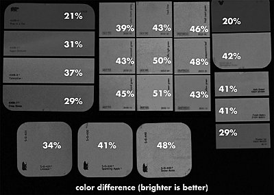

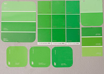

I picked up some samples at Benjamin Moore, and did a bit more testing...
It turns out that Sparkling Apple has very balanced R&B levels, but there are other greens that may key better under white light.
For example, Benjamin Moore 2032-10 ("Neon Green") gives a G level of 61% versus Sparkling Apple's 74%, but Neon Green absolutely demolished all the red (0%! vs 38%), and absorbed blue better as well (18% vs 30%).
That means that the color difference value between R&B and G for Neon Green is around 51%, versus 41% for Sparkling Apple. In fact, Behr S-G-440 ("Green Acres") gives 48% color difference, so it may be a better choice if you're buying Behr paint.
But I think Benjamin Moore's Neon Green and Traffic Light Green are the best bet. I couldn't believe that Neon Green was absorbing 100% of the red in white light!
Note that if you're mostly using green light, you'll want a lighter color like Sparkling Apple which reflects more green...
The next step is actually painting some canvas...
