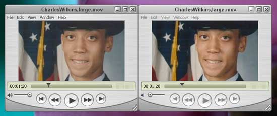

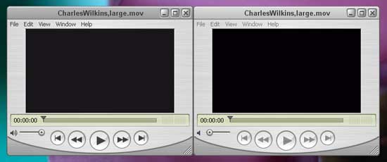

I’ve done some more research on this problem. Apparently, the issue is caused by hardware acceleration, in particular Core Video on the Mac and DirectX DirectDraw on the PC. Somehow this must be tied in with QuickTime’s rendering of H.264 embedded ICC profiles.
I confirmed the problem is related to hardware acceleration by opening in QuickTime Player 7.2 an H.264 video I encoded, and playing it with and without DirectX acceleration. See attached screen shots at the end of this post.
Visit these links for more information:
Quicktime Player h.264 Bug
Update and comments
RE: Core Video/ H.264 Color issues
To quote a Robert Spryn from the second link:
“I spoke to one quicktime engineer. All I got out of it is that this is a problem they are aware of and working on, and that detailed information on the problem like I provide is helpful.”
This comment was posted on June 26 of this year.
To sum things up, nothing is inherently wrong with the H.264 format; it is QuickTime Player’s handling of the embedded ICC profiles that is at fault. Thus, I would strongly urge against doing anything like increasing saturation or decreasing the brightness of your project in an attempt to correct for this problem when exporting to H.264. If and when Apple fixes this issue regarding ICC profiles and hardware acceleration in the QuickTime Player, any H.264 videos so corrected could end up being rendered rather, well, interesting.
Regarding the screen shots below, in each of the two the QuickTime window on the left is being rendered with DirectX hardware acceleration, and the window on the right with Windows GDI.
