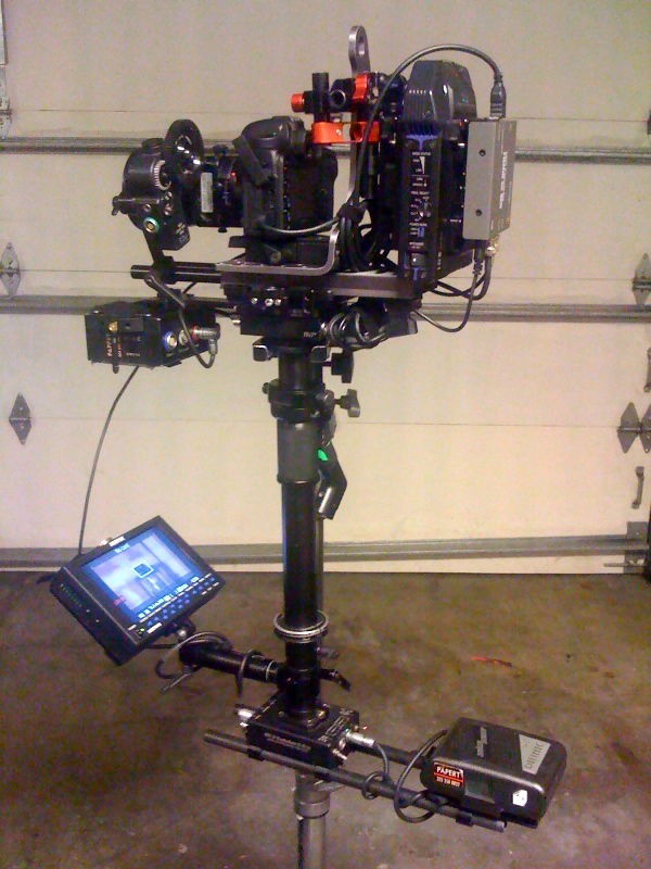

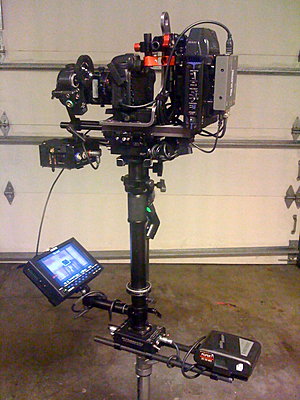

Here's a pic of my prep set-up--just a 5D on it at the moment but it's ready for the 1D. Blackmagic converter works beautifully, HD-SDI signal is much more stable than the HDMI (just finished a shoot with a Marshall HDMI monitor, all sorts of issues there--you tap the monitor and the luminance shifts!). That's it piggybacked on the rear of the Camwave transmitter. Bracketry is all cobbled together from my bits and pieces--not as slick as a custom mount but it is solid and will get the job done.

In theory, the HDMI signal should be just at stable. The main problem for pro work is that the connector isn't captive. It's really designed for fixed installations. Assuming that you're not messing with the connector, it sounds like you have a bad solder joint in the monitor.
An HDMI to HD-SDI converter makes a lot of sense for pro applications - it's captive, it supports long cable runs, and you can run it to a DA to split the signal for a video village.
Yes, and on top of that, I have yet to see an HD-SDI monitor that doesn't offer loop-through, so you can loop out of your onboard monitor for a director's monitor. Actually, the Blackmagic converter has two HD-SDI outputs so you would have 3 possible outputs with that setup.
