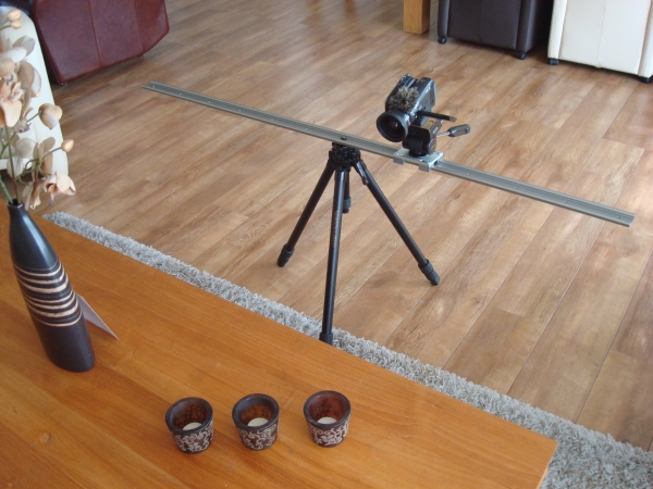

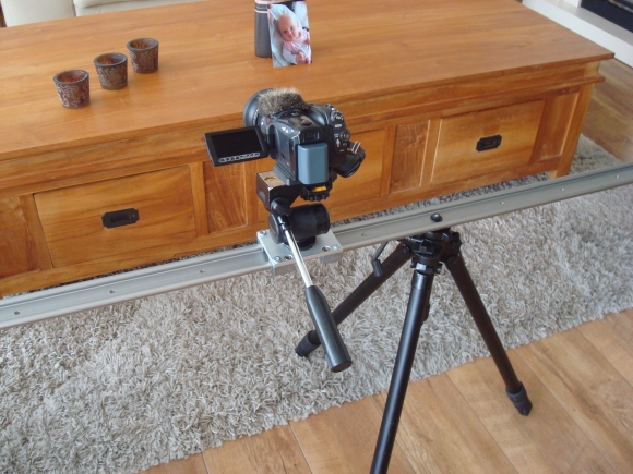

A few weeks ago, before I read this topic, I happen to run into the Igus rail + slider via a Dutch website and ordered 1.5 mtr. With that I build my own glidetrack. Now I see this topic and thought: I might as well share my findings.
The first (without head) and second (with head) test results can be seen on Vimeo (here and here). I discovered that smooth gliding is something you have to learn and doesn't come by itself. And after a long doubt I rubbed some olive oil to the rails with made it slide like a charm. I now can give the slider a push at one end and it slides 1.5 mtr to the end by itself. And for a simple straight slide I now use a small rubber band with wich I pull the slider (as low as possible).
But I did not succeed yet in sliding and using the head at the same time. I thought that would make it possible to "curve" around the subject. But that needs a lot more practicing I'm afraid. On the fotos is the first setup I tried. In the meantime I bought myself a new Manfrotto tripod with a new head and screwed a few QR adapters here and there so now everything is quick interchangeable. Next to test is with the XHA1 instead of the HV30.
