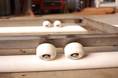

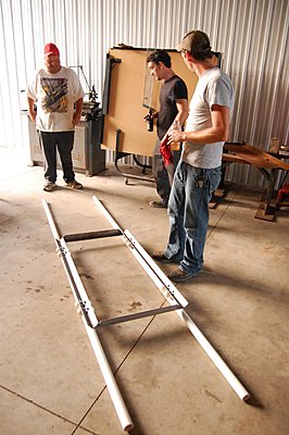

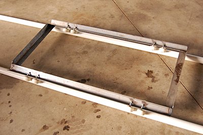

Here is what I have thus far but I am wanting to raise it up off the ground.
