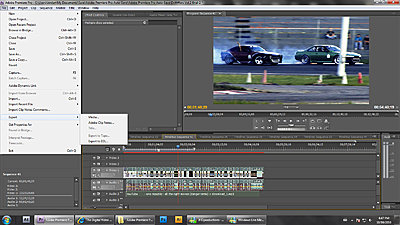

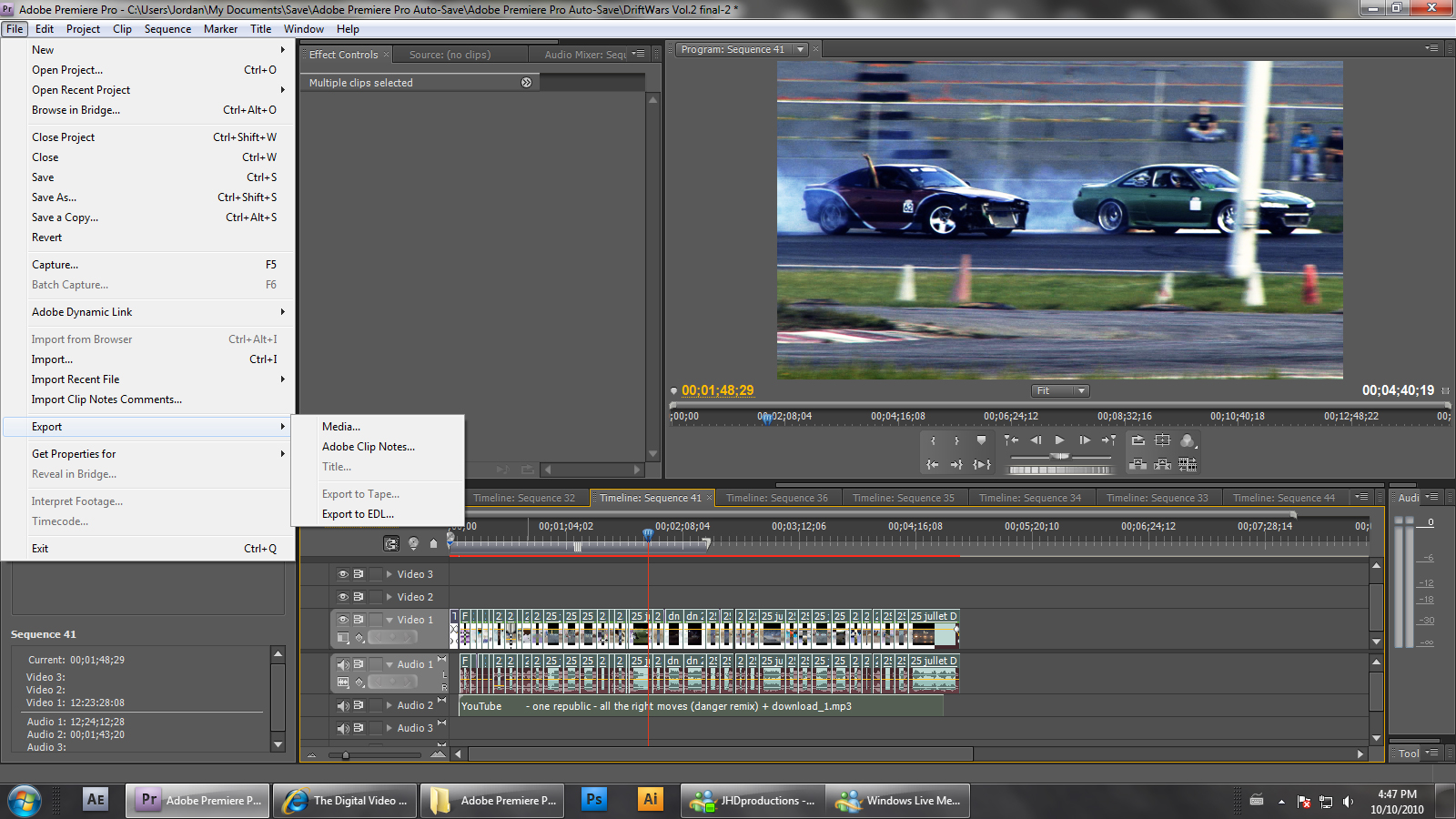

I cant find export to encore
Noa : Im on CS4

Apologies, I use CS3,
For CS4, try this:
Adobe Dynamic Link > Export to Encore. (but keep your Bridge open).
The reason why exporting directly to Encore makes sense is because you avoid the intermediate transcoding to an AVI or whatever. Of course, you can export to uncompressed AVI/TIFF/MOV, etc. Source is directly converted to MPEG-2 according to the quality settings correct for your particular project/footage. It gives great results and I've done whole movies this way with spectacular results. Never needed another software or work around.
If the Dynamic Link route is not working for you, then you'll need to render to an intermediate codec for your final footage. Why don't you try taking a small slice (a minute or so?) and render to AVI (compressed but keep medium settings) and then import this into Encore and burn a test DVD using a RW DVD? Keep the bit rate at 6.5 CBR and watch it on a player. Then take it from there.
