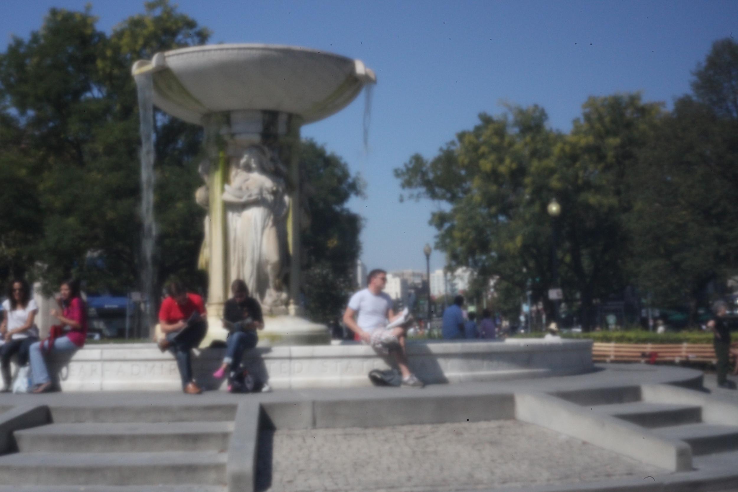

What better way to use a $2700 camera body than with a $0.01 lens? At ISO 6400 it is possible to shoot video at 1/30th of a second. The effect is very odd, almost like a Super-8 film.

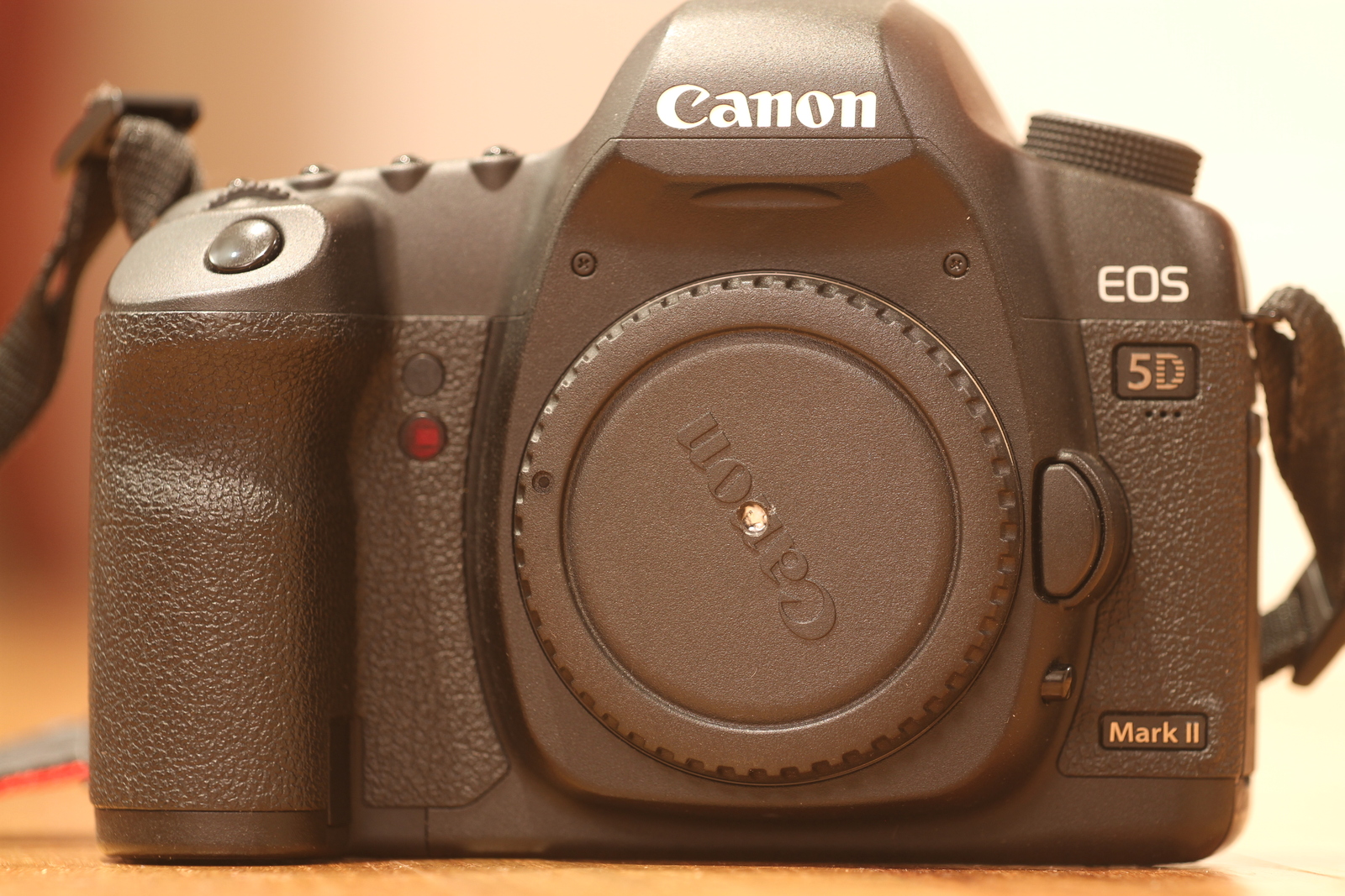

There's not too much to it. I drilled a 4mm hole in the body cap, taped a piece of Aluminum foil over it on the inside and poked a tiny hole in the foil with a needle. You can see the simplicity of the "lens" in the attached photo. Metering doesn't really work, so it takes quite a few manual shots to get it right.

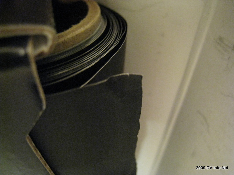

Use matte black foil (available from Lee Filters) for a less obvious, more covert approach.

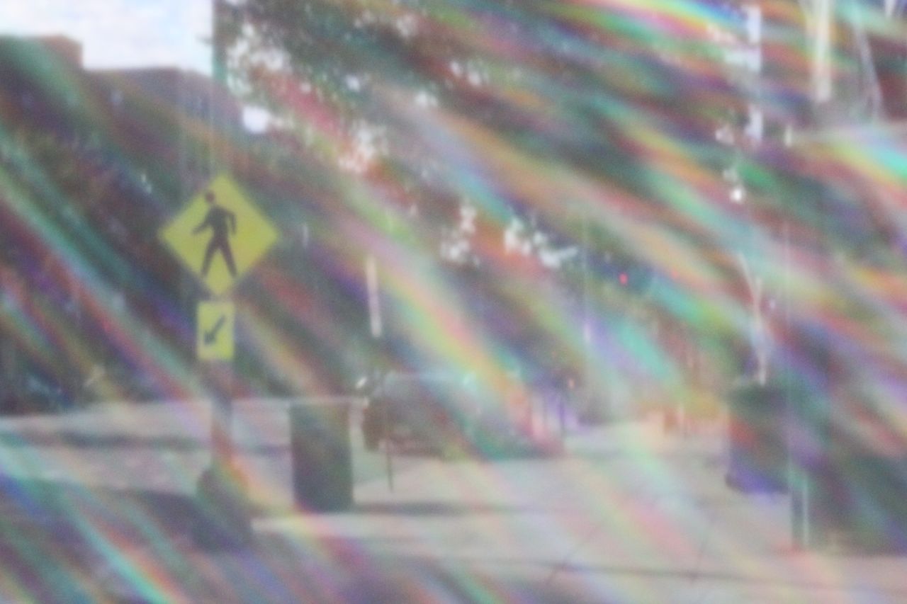

The black foil would likely also prevent this weird reflection problem when shooting into the sun.

More on the Black Foil:
http://www.leefiltersusa.com/lightin...4630B29462927/
Spare EOS Body Cap:
http://shop.usa.canon.com/webapp/wcs...0051_171117_-1
