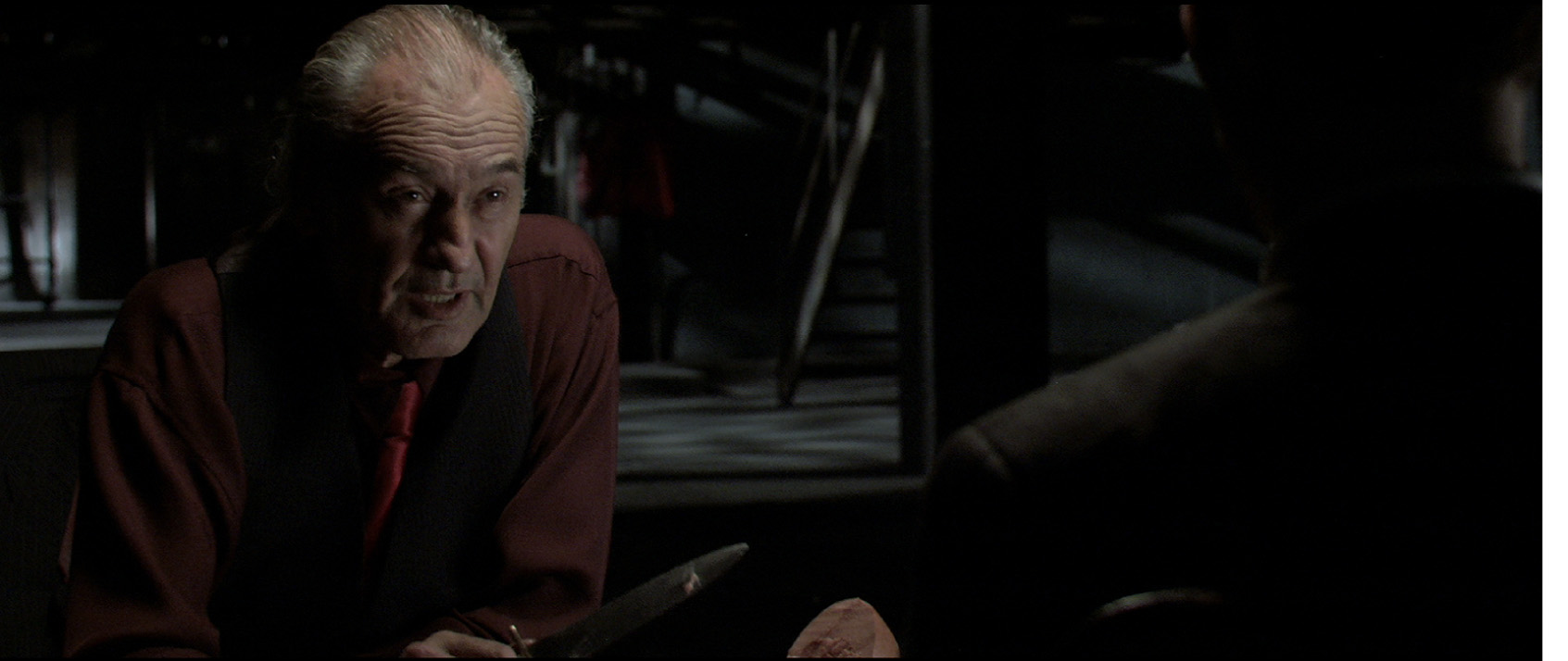

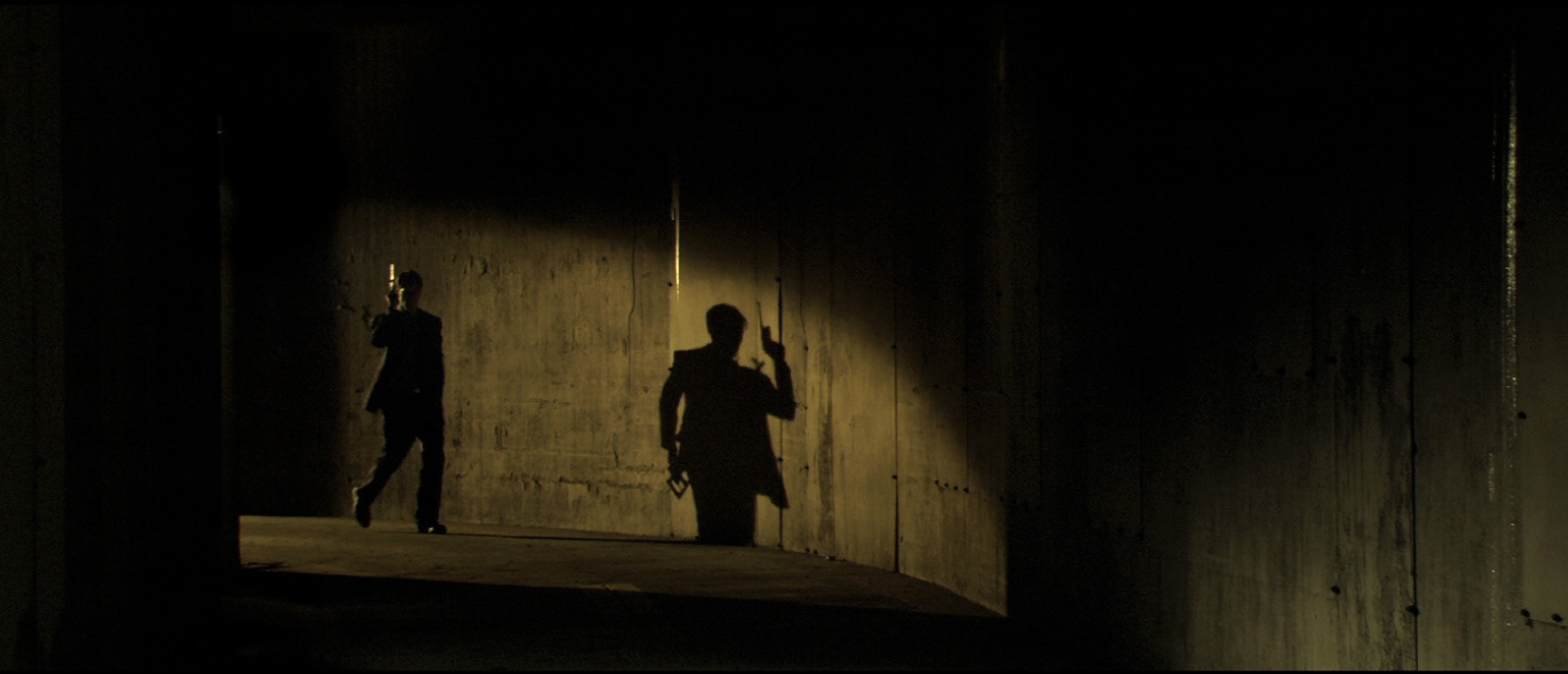

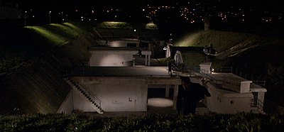

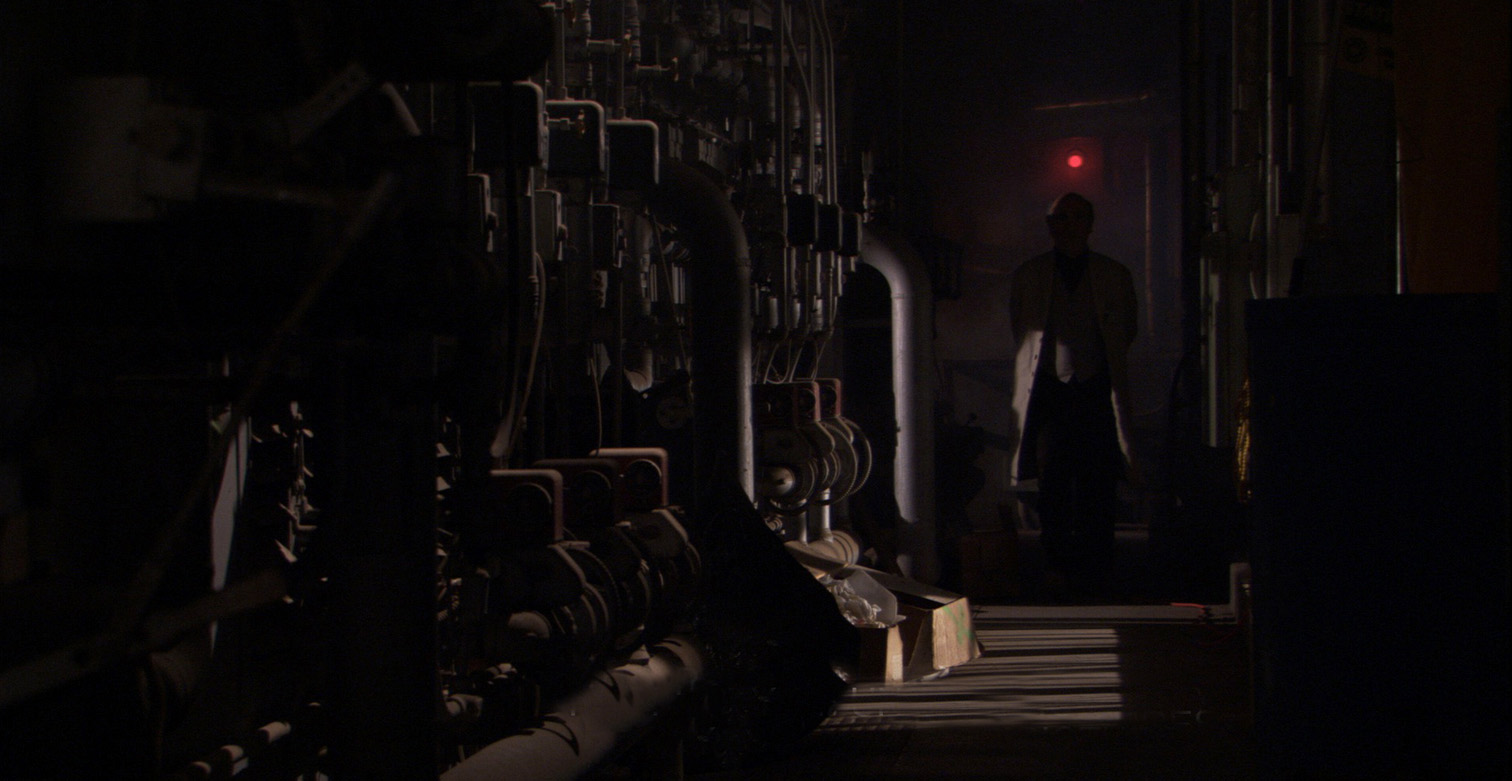

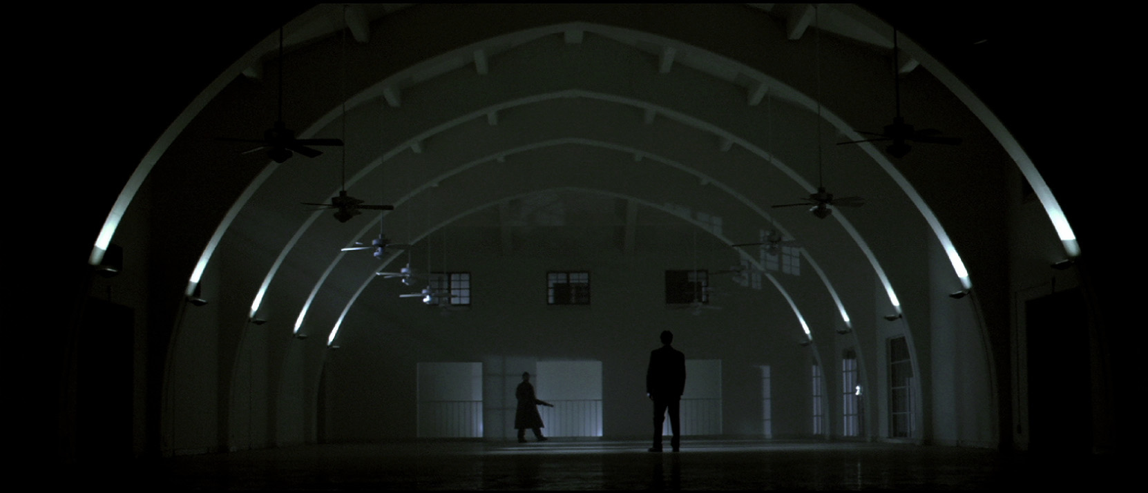

It may help to think about working with shadows on the face vs on the background--often it takes different approaches for foreground and background. To create a mood I will often break up a hard light on background with a homemade gobo--strips of 1" or 2" camera tape applied gently to a single net can achieve a very custom effect. Last weekend I was shooting a short film and needed to create a broken-up late afternoon sun effect in an interior with very little gear; this technique served me well as I was able to "erase" the light from places that I didn't want it. As far as knowing where you do or don't want it, that's entirely personal taste and the joy and artistry of cinematography. Seek out and study paintings, photographs and DVD's that you like, dissect each and then try to duplicate the look at home. Remember that the harder the light source (and the further a gobo is away from a light), the more pronounced the shadow.
Since a picture is worth a thousand words, as they say, I've attached some frame grabs from a film noir feature I shot--a genre that is all about shadows, of course. I'd be happy to answer specific questions about how these were achieved, if that would be helpful.
I would love to know what techniques were used in these grabs- especially the dialogue grab. Also, the only thing about studying paintings is that once you start to try the techniques in your tests or productions you realize that either the subjects, or the canvas, or both move and ruin your carefully set up portrait. Unfortunately, emulation is a very difficult part of the learning cycle in this case.

For the dialogue shot, there was a hanging practical lamp over the table in the middle of this huge basement (old newspaper printing press room), so the lighting on the actors was largely emanating from this source. For a given setup I cheated the table and actors so that the angle of the light was optimized for each shot, much easier than adjusting the practical which was hung from above. There was a also a small eyelight, probably a dimmed down 300w tungsten unit, positioned on the floor to the right of camera.
The background was lit with a series of larger units, probably 2K and 5K open faces from the catwalks above the floor, aimed through the stairways and railings to create the broken pools and shadows as seen in the shot.
There was a 360 degree Steadicam shot that played for one version of the complete 3 minute scene, so all of the broad lighting had to be set from above.
You can see all of these stills in action, including a few more angles of the above scene, if you go to my site (charlespapert.com) and click on "The Perfect Sleep" trailer.
