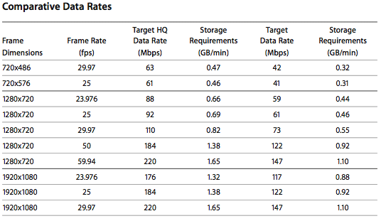

I'm running a wedding business and doing everything apple pro res 422
The thing is the amount of space this codec takes up
If anyone else is using this codec how much disk space do you have to use this codec without filling up your hard drive every time you log your footage

I just transferred 2 hours of AVCHD footage to ProRes422 yesterday. I started with 7GB from the camera and ended up with 88GB worth of Quicktime files after transfer. I was using the ProRes422 HQ codec which might have increased the size even more.

I shoot 720P60 HDV and capture as ProRes422 720P60 and I'm using right about 1GB per minute. I guess I've been at this long enough that the price per minute of captured footage still seems low in ProRes given the cost of drives these days.

Check out http://images.apple.com/finalcutstud..._ProRes_WP.pdf
