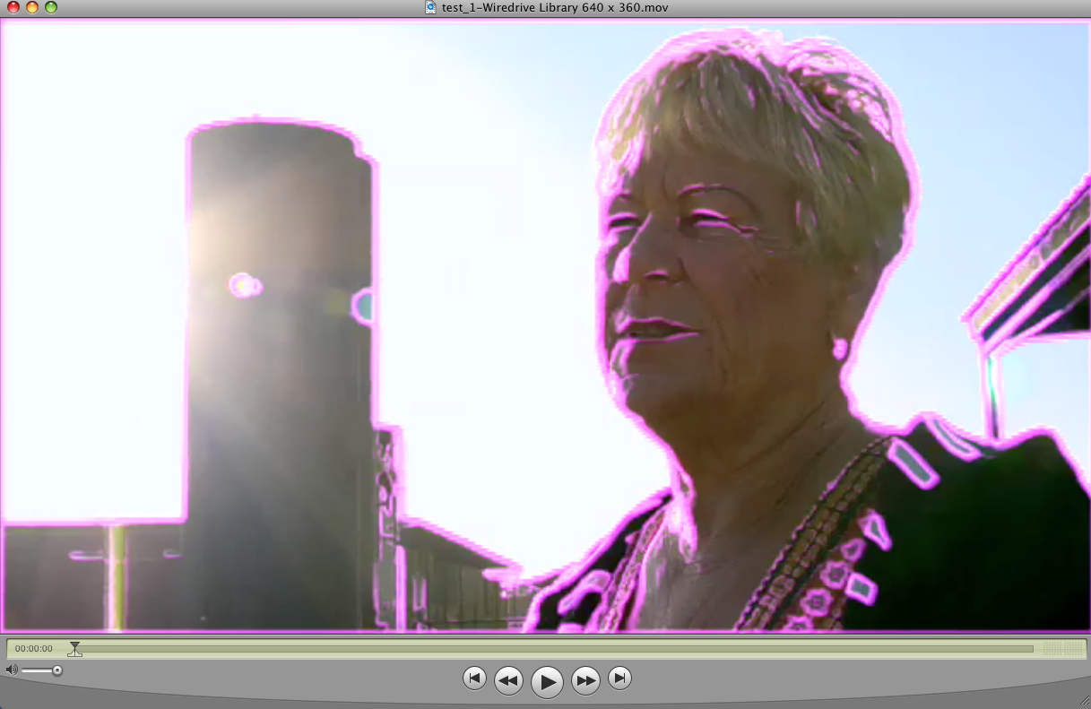

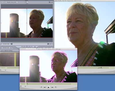

After upgrading to FCP7, I've been getting some interesting pink highlights with ANY codec I export from a ProRes source. The material is 23.98 422 (see screenshot).
Has anyone else experienced this yet?
The only possible solve is to take the ProRes source and encoded it uncompressed 8-bit, although these create monstrous file sizes. The codec works as expected with everything else.

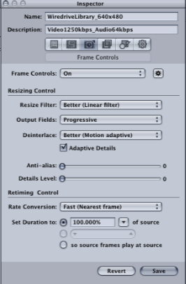

The fix was in the "Details Level" under Frame Controls.
It needs to be set to "0". (see attached)
Hope this helps someone else.
