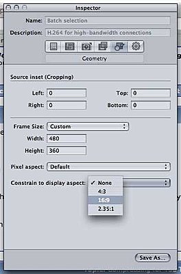

OK, take a look at this one that I did of my kid's band practicing (it's not high art...just did it for them to post on their MySpace pages).
http://www.youtube.com/watch?v=zrfhCkJP8H8
What I did here was to output using the H.264 800Kbps Quicktime 7 preset in Compressor. But you have to go into the second to last tab in the compressor settings ("Geometry") and click the bottom-most popup ("Constrain to display aspect") and choose "16:9".
The resulting video will be quite large, but as long as it's under YouTube's max file size (100mb), they'll re-compress it and letterbox it (like they did for mine).
Don't overthink the problem. Throw the highest-quality thing you can at them. It'll look better when they're through mashing it down.
