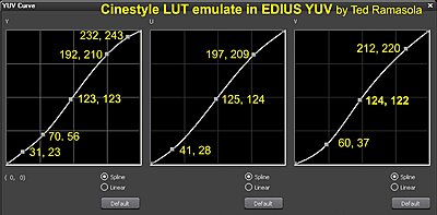

I do quick grades in EDIUS with my 5D footage with cinestyle color profile and its a cumbersome process to go to AE to access the Cinestyle LUT for reference in grading,
so I made an emulation of the Cinestyle LUT with the EDIUS YUV color corrector filter.
It might not be perfect but I think its close as a starting point and or reference for grading using other tools.
Here's a snapshot of the curves and the node coordinates so you can copy it and save as a user preset. I saved mine and called it CINESTYLE LUT Emulate YUV.
And also frame grabs of Cinestyle RAW /Cinestyle LUT applied from AE / Cinestyle LUT Emulation YUV in Edius.
Hope this helps 5D and Edius users out there. Do feel free to tweak it to suit your taste. :-)

I've edited the attached curves as the first one was based on an HQ exported avi, to further cut on workflow I now based the curves on raw mov files from camera.
Thanks for sharing this. Do you know if there's a way to enter the coordinates manually? It's really difficult to get the exact numbers by mouse dragging.
Sebastian Alvarez is offline   Reply With Quote
Old October 27th, 2011, 10:55 PM   #6
Location: Allen, Texas U.S.A
Posts: 1,117
Re: Cinestyle LUT emulation with EDIUS YUV
Use the arrow keys Sebastian.
