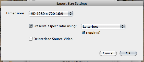

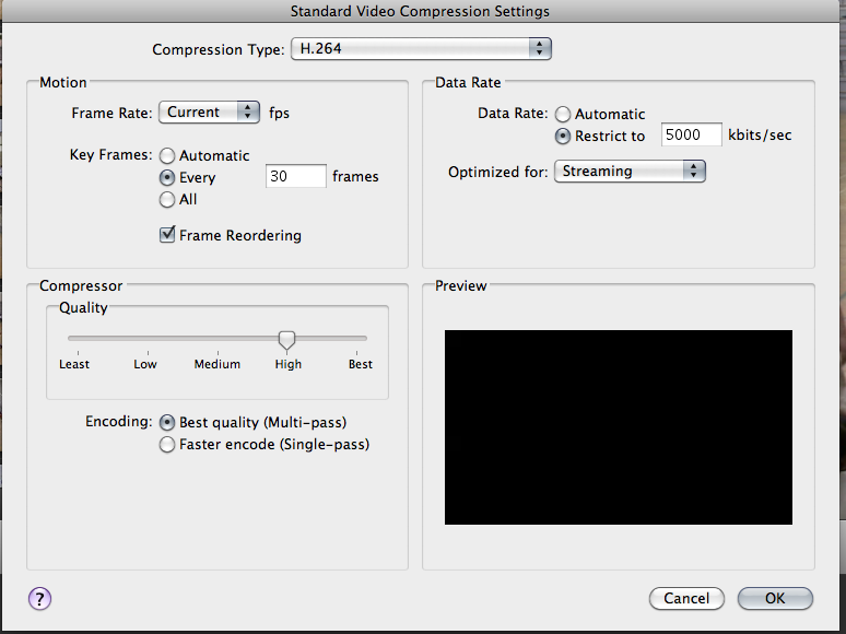

I need to know what I'm doing wrong. I have use iMovie 09 build [8.0.6] on (4) different Macs ( MBpro 13/15", 27" i7 iMac and mac mini ) All the units are running OSX 10.6.3. I also use Final Cut Express 4.0.1. I shoot sports events with a Canon HDV30 using 30p and import to iMovie. After my footage is cut I end up with ~1hr worth of footage. The problem that I'm having is that is takes a minimum of 24hrs or more to encode (1) event to Quicktime using the following settings.
Video::
compression: h.264
Quality: high
Key Frame rate: 30
Bitrate: 5,000 kbits/sec
Frame reordering: yes
Encoding mode: multi-pass
Dimensions: 1280x720 (1248x702)
Scale: letterbox
Sound::
Format: ACC
Sample rate: 44.100 kHz
Bit rate: 128 kbps
This same length of time occurs when i export to FCE or iMovie. I'm trying to achieve high quality HD video for Vimeo. What am I doing wrong? Did something change in Quicktime via a patch or with OSX 10.6.3? Although I'm running Snow Leopard i also installed the legacy Quicktime 7 version. Please help, I'm shooting 5-7 games in a weekend and right now I don't have time to get everything processed do the amount of time a single encode is taking.
Any and all help and comments are greatly appreciated.
Please review the attachments for additional information.
Would I gain anything by using .mp4 vs .mov

I agree...sounds a little long to me but on those computers, reasonable. To really bump up the speed, the multi pass option could be turned off.

Is there any specific reason that you have "Frame reordering" on?

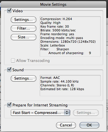

I've noticed that you've got filtering enabled....Get rid of it. It will destroy your times..You're better off filtering in post, and let the encoder do it's job..
Also, if time is a problem, use VBR 1 pass...
