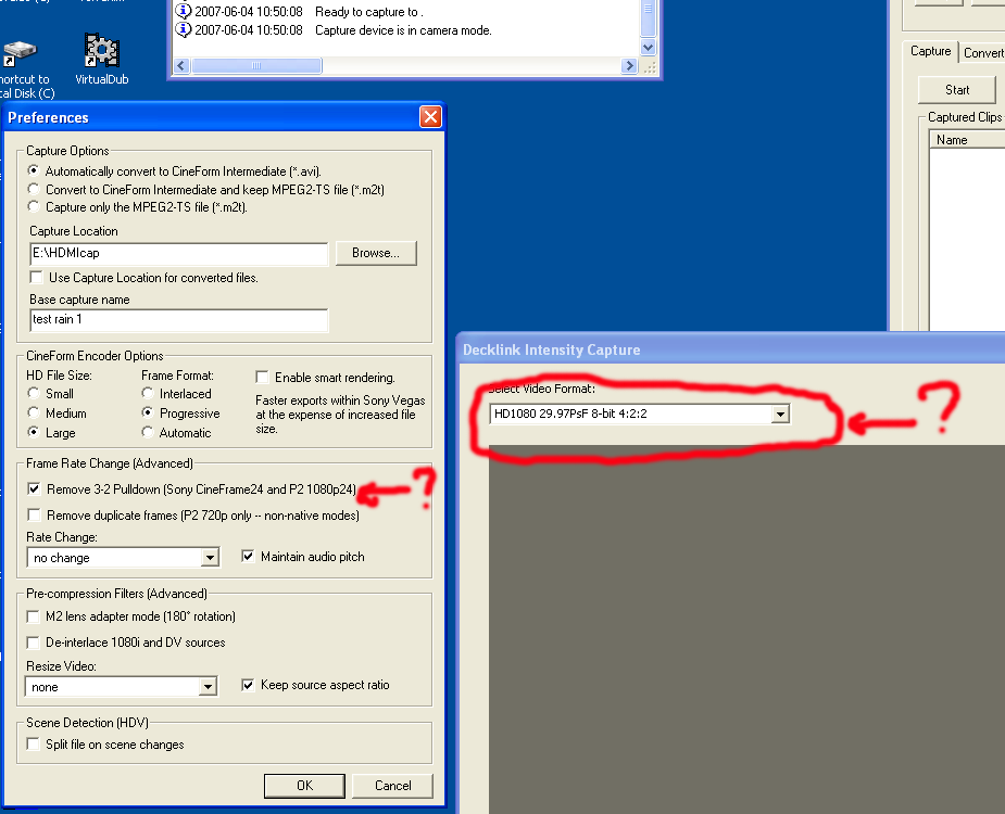

Here's my AHD capture setup with Intensity - see screen capture below.
Its' strange to me that Aspect forces Intensity output to 1080 29.97P while in fact it is capturing a 60i video (well, 24p intertwined into the 60i stream...)
Again, the idea is to capture 24p as comes out of Sony V1U via HDMI into the PC running Aspect HD 4.3.2 that removes 2-3 pulldown on the fly, leaving me with the pure 24p (23.976 actually) Aspect HD avi file in 1440x1080.
Just wanted to make sure this is not something I'm doing wrong with the capture settings ?

Alex,
I didn't realize that you had the old Xeon, even with two CPUs that can be trouble. While each core can be fast, their access to memory is extremely poor. You do have a 800MHz front side bus so that will help, but we have not tested old Xeons in any configurations for the Intensity. When we first didn't live capture via HDSDI we only recommended AMD Opteron, and now with Intel Core 2 proc, pretty much any dual core will do it. I hope you are not spending too much for that second CPU if doesn't work.
Those settings should be fine.
