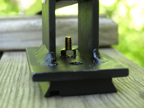

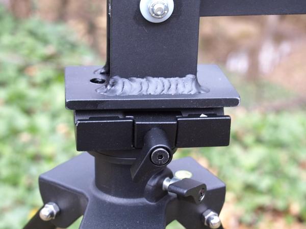

I have the bottom of the jib bolted to a 501p mounting plate. I am using one bolt but could have used two if necessary. The 501 then slides in and locks to 577 quick release adapter which is attached to my tripod via a 3/8" mounting stud. http://www.amazon.com/Manfrotto-577-Connect-Adapter-Mounting/dp/B00009XV3M/ref=pd_cp_p_0
I got a budget crane/jib, how do I best use it?-p1014497.jpg   I got a budget crane/jib, how do I best use it?-p1014488s.jpg
