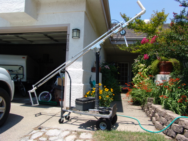

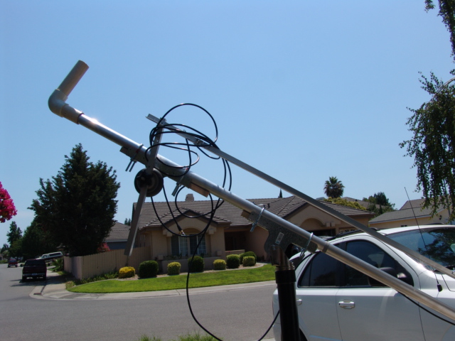

Made this Lightweight crane for my HV20
I just fashioned this light weight crane/jib that will extent about 12 to 13 feet last weekend, for use with a light camera and perhaps Letusadapter.
Uses a heavy umbrella stand as base, upright is piece of sewer pipe over an umbrella poll. On the cap at end of sewer pipe, I mount a caster swivvel from about a 5 inch caster wheel. Took the wheel out, but actually used it as a friction device for the camera up and down direction adjustment. Bought u- brackets and some hardware from Home Depot to mount the swivvel and the camera up/down adjuster.
Made boom from aluminum tubing. Everything is sitting in picture, on a standard cheap handtruck/dolly truck..
I imagine it will be difficult to use a Letus adapter on a crane. You will have to build a support platform long enough to accomodate for the support rods holding the Letus.
I've noticed everyone has tires instead of a track. I would assume that this would make the entire crane wobbly. What are your comments?
Terry Lee is offline   Reply With Quote

First, I did not envision shooting while moving the crane. But I will try some tests this weekend to see what it does. My intentions was that this be for a stationary shots, and mount on dolly was only for easy of moving. That umbrella stand is very heavy.
As to Letus, I use the 35a. It can be shot without rods, though I will have no problem adding a lightweight support for it from scrap aluminum....
