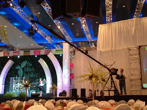

A great investment
Terry, I'm in Louisville also and you can go to my site and see everything about my jib, how it's used and different set-ups involved. Call if you have any questions.

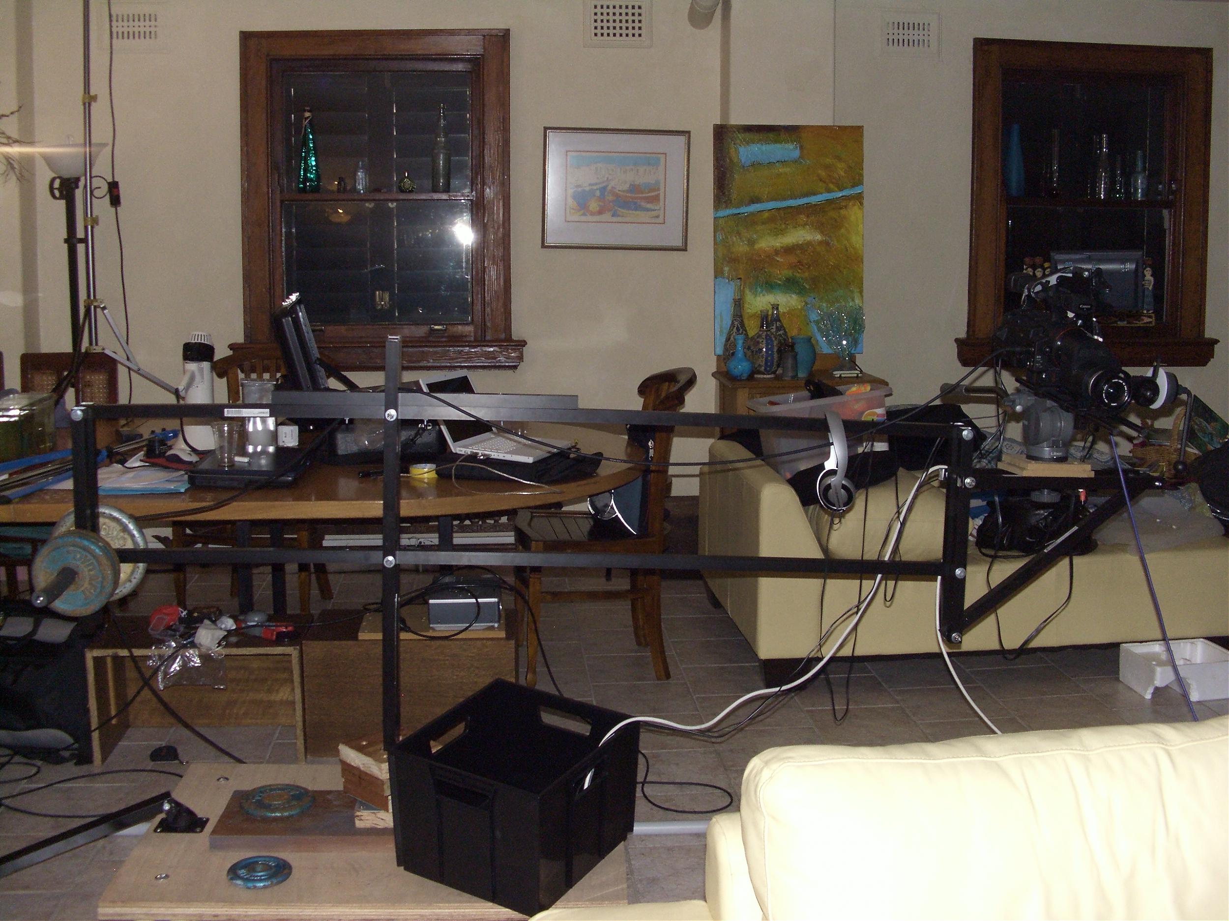

here's mine
it needed some reinforcing from the original design but it seems to work pretty well. I'm going to double the length but it would only take the weight of the A1 not head, LEX and lens.

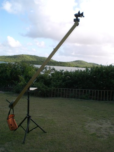

Here is mine
Its a Pro Jib 9.0 with a Bescor pan-tilt (good enough for what I do), I use the bag to hold a 2 liter bottle so I can "fine" trim the balance. It stands on a JBL speaker stand (roughly 24lbs of weight plus the crane is about 16lbs and the cam and head are about 5lbs or so). I have pics of how it is attached to stand on a different thread.
I like the low profile of this crane. I will probably upgrade the head to one of those Servo City ones in the near future. one of the things I really like about this crane is that it easily breaks down into 3 x 3' sections, so I can use it as a 6' er as well. I am trying to get a hold of another section so I can go to 12'
If you're into Cricket , you might see shots from it on Stanford 20/20 tournament this February.
