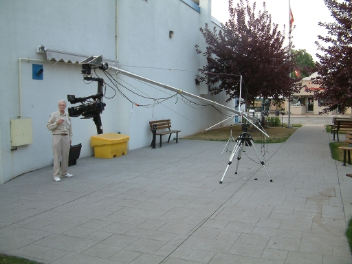

I purchased a Kessler Crane and still use that some times but I wanted a longer crane so I built my from my own design, that I thought out, after looking at other cranes. No actual Blue prints or plans.
DaNc

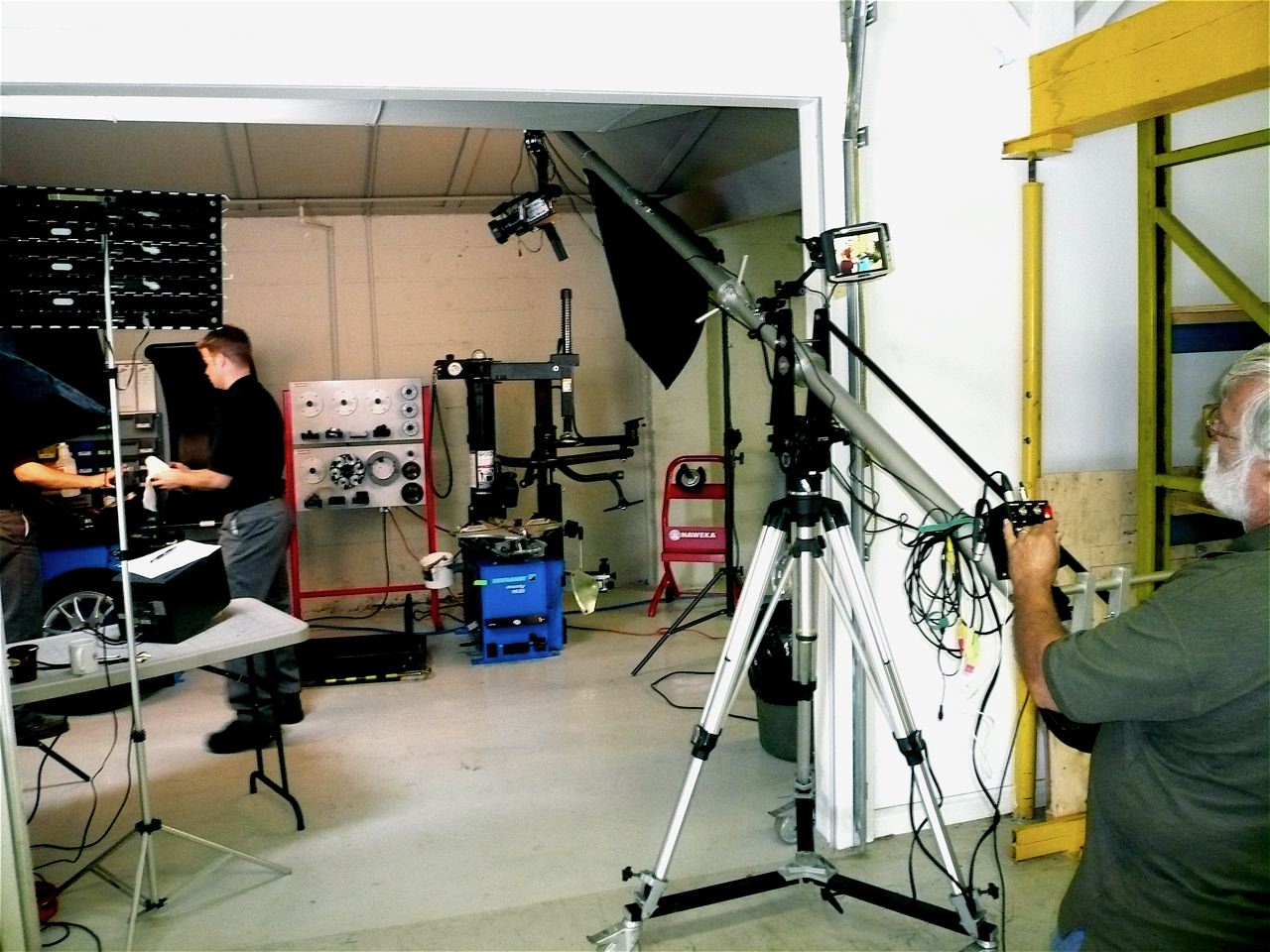

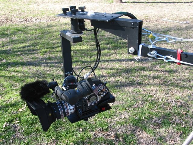

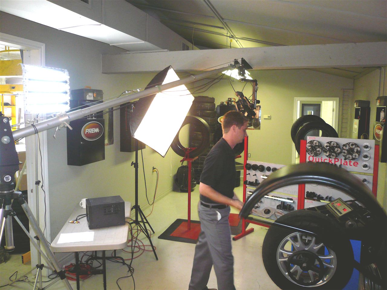

Here is a link to a video that was shot with the telescopic crane at it second length. All of the shots were done on the crane as it proved to be a lot more flexible than using a tripod, and it was shot in a tight space . If you look at the photos on the slide show you will see I was outside the room operating the jib.
http://www.cdvideo.ca/wordpress/?page_id=116
Post a photo of your crane!-prema2.jpg   Post a photo of your crane!-prema3.jpg
Post a photo of your crane!-carabana1.jpg   Post a photo of your crane!-dscf0014-b.jpg

Yes I did and it is not really that compex the hardest part was making the yoke for the tubing, so that it can slide into each other past the folcum, and using collars for the stabilizer cables. It all fits together in a 6 foot length. I am building a different head to get away from joystick controller to more of a tripod feel.

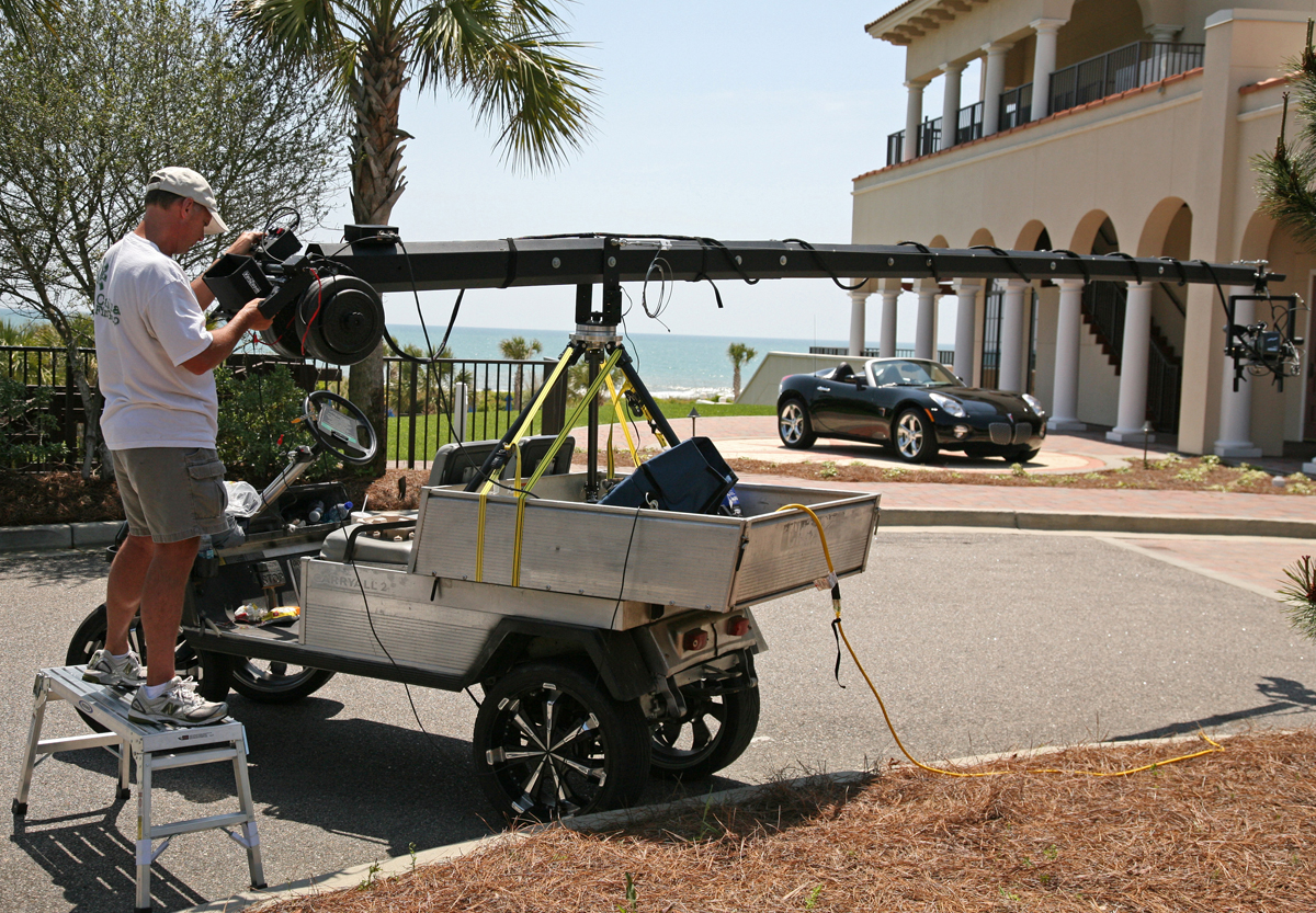

21 foot Jib on a golf cart
We were able to get mobile with the jib by strapping to the golf cart!

I love that the golf cart has 'rims'.

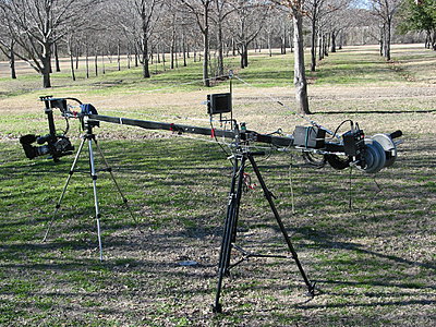

Pics of my Pro Am 12' jib I've modified for a PT 20 remote head with cable supports for extra weight, remote head mount than can be over or under slung, it can all be mounted on my tripod w/ skates for rolling around for quick placement (after it's built and balanced), Varizoom Pro for zoom/focus.
Post a photo of your crane!-jib.jpg   Post a photo of your crane!-pt20-leveling-head.jpg

We're working on a "low rider" version of the golf cart :)

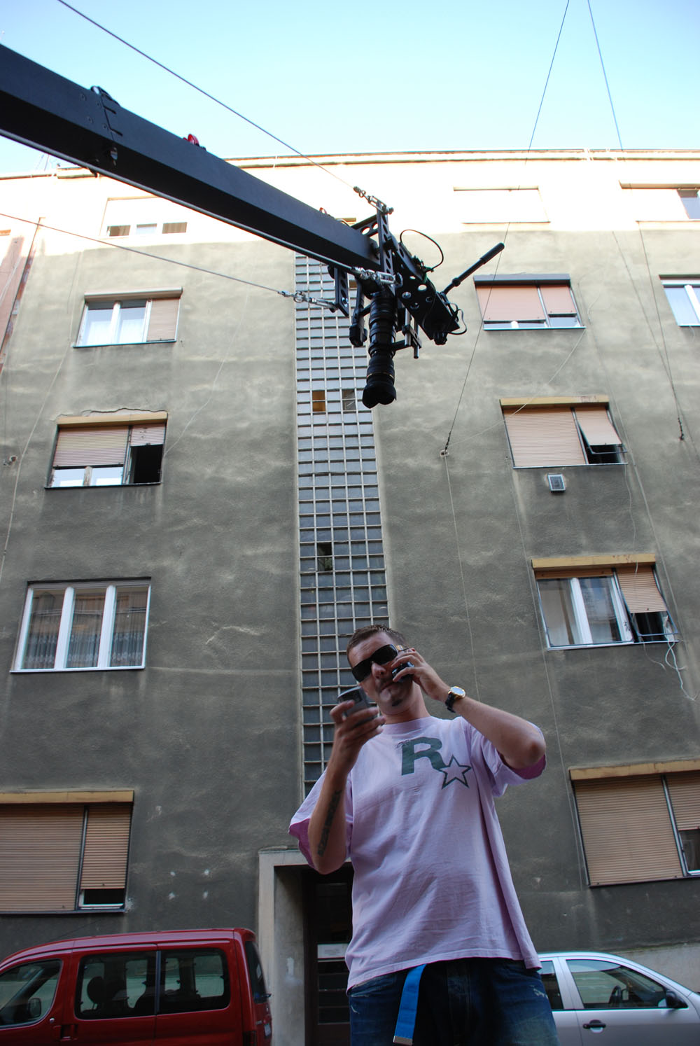

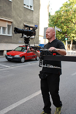

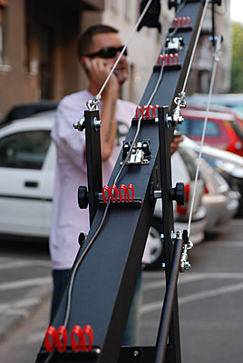

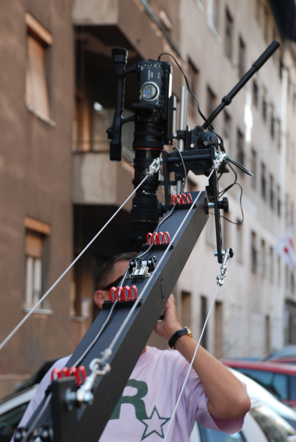

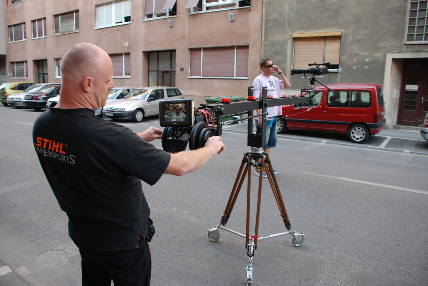

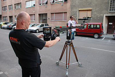

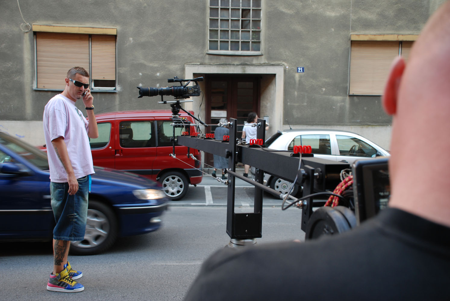

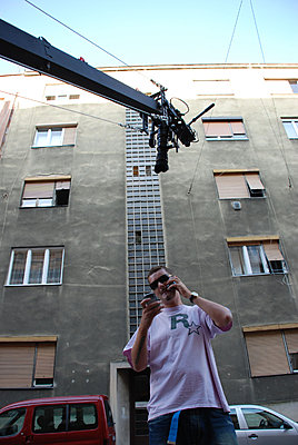

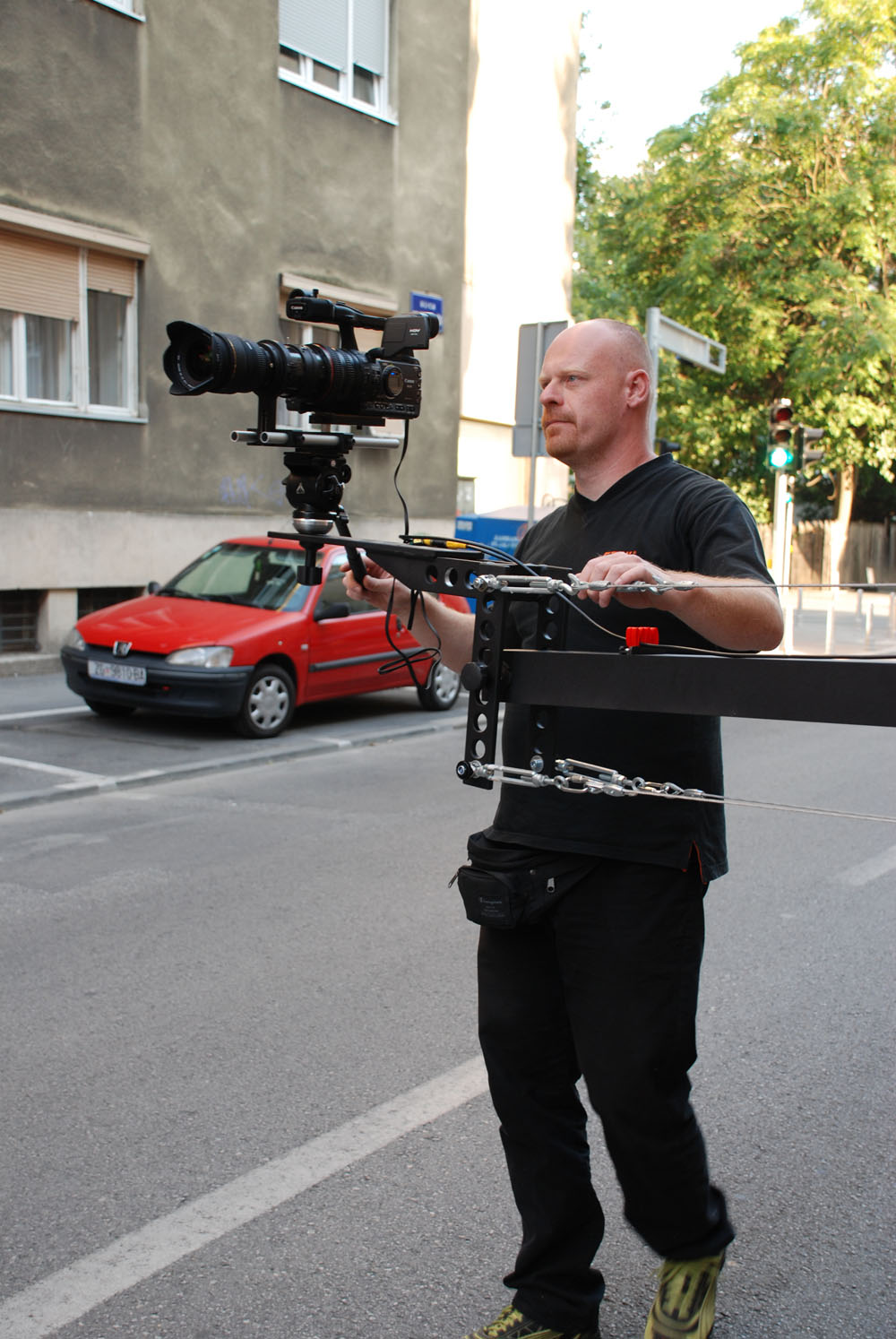

My Crane
On those pictures is my DIY crane in 2.5m length from middle point. I have one extra 1 meter length aluminum square tube 7x7cm and this is max length. It can be break down in two large keyboard bags. On pictures is Canon A1+Brevis+rails+Sigma 24-70. Counterweight is 18kg plus LCD and large 12V7.2AH accu. It can be put on tripod in about 10-15 minutes. We are using it for documentaries and music videos. We have to change tripod for better one, something like new kessler one. Tripod that we use is old wooden cinema camera tripod.
Post a photo of your crane!-dsc_0119.jpg   Post a photo of your crane!-dsc_0121.jpg
Post a photo of your crane!-dsc_0126.jpg   Post a photo of your crane!-dsc_0140.jpg
Post a photo of your crane!-dsc_0141.jpg   Post a photo of your crane!-dsc_0143.jpg
