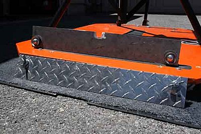

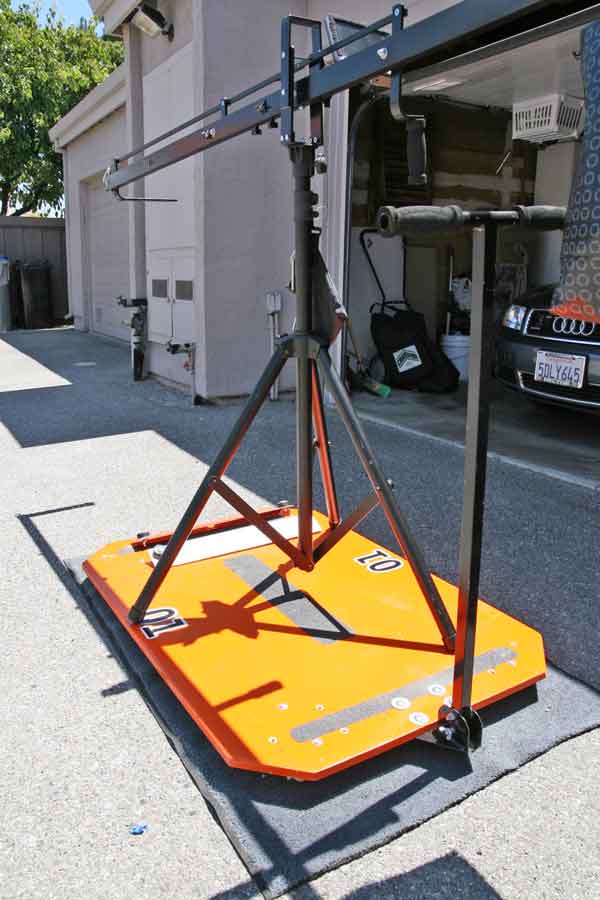

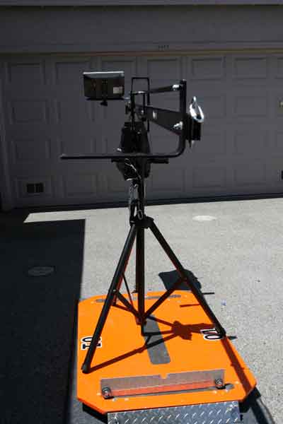

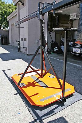

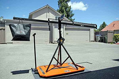

Ok, here's my set up. It's the Pro Am 250 with the optional extra 4' section. I didn't install the piece when I took the shots. But it booms out 12'! The only mods I've made so far is a tension wire that runs front to back. With my XL1 mounted on it, the 250 tended to sag when lifting. So I just made a new extension for the fulcrum and added eye bolts to the ends. I also made a little are to hold my monitor.
As you can tell I built the dolly myself with 3/4 or 1" ply. I had my friend weld up the wheel chassis, and push bar/yoke. The hardest part was drilling the holes for the axles.
The bearings are abec 5 and they're not to noisy. Running on 1 1/2" pvc we encountered a whirring sound. So I made the track ends out of aluminum diamond plate and 1 1/2" ABS test plugs. I found when you plug the ends of the pipe, it really makes the noise level drop. Plus it helps keep the pipe lined up and gives me a solid stop point.

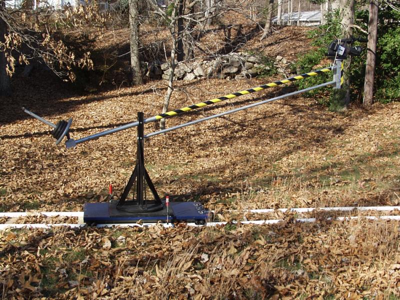

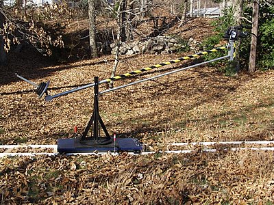

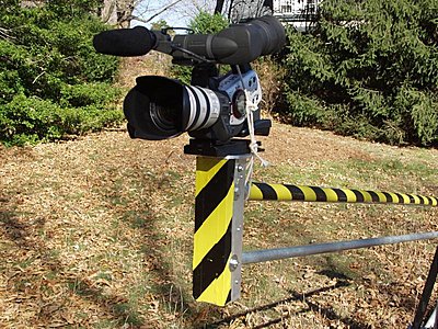

Here's m DIY jib.

Hey Bill, What are those things that look like screw drivers handles. Is it some sort of parking brake?

James,
No, I hold the jib to the dolly with clamps, those are the clamp handels.

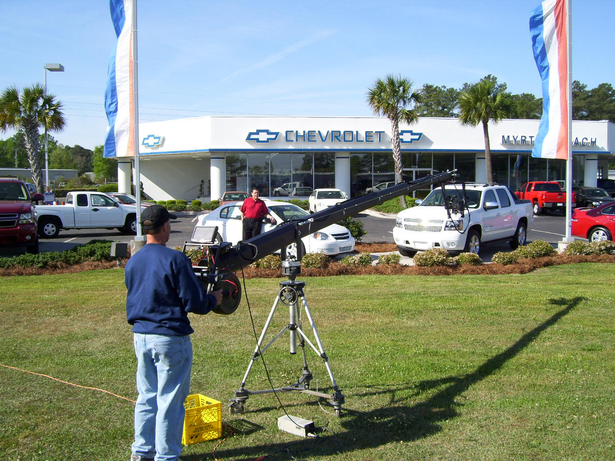

my jib pic
Here is my 21 foot JonyJib. We did a series of "fly arounds" with this Chevy dealer. Looks great!

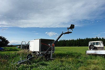

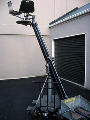

muh crane
Here are some very unflattering pictures of my crane. It rides on a modified matthews doorway dolly. Max height is only about 12 feet, but since it can fly 2 people on it, there are a lot of fun things you can do. In the second photo ignore the tall grass that i was lax in mowing... and thats an upsidedown wheelbarrow next to the crane, not part of it. Orange strap on crane is just what i use to lift it in and out of the truck. (swing crane in the truck cranes the crane, so i can load/unload/build it by myself.
crazy, eh?
