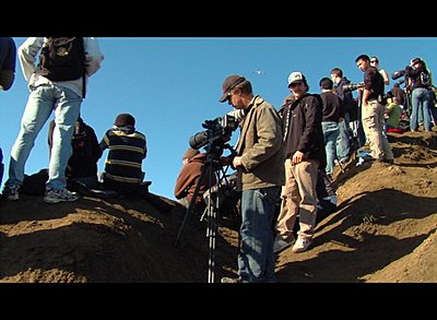

Eric deserves all the credit for this video, he did all the work--I did all the complaining. Here's a Hd100 frame grab of Eric and the 300mm Nikon shooting the competition.
The previous week California was drenched by a series of storms so the hillside, was muddy, crumbly, and 100% unsafe. I kept waiting for the whole thing to slide in to the sea which would have been horrific--just think of all the incredible camera gear that would've been lost!
