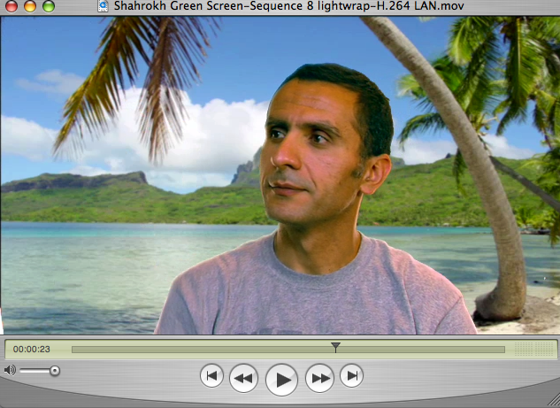

Nicholas...whilst you're on...you might want to look into 'light wraps' on your completed green screen. Not sure if some of the more professional folk on here would recommend it but it made some of footage far more realistic (I've added an example of a light wrap below). I'd worry about that last though and make sure you've lit everything and followed a few basic rules first off.

David, could you explain Light Wraps? Thanks.
Paul...I'll try and dig out the bookmark with a step by step guide as the process is a little convoluted for me to even attempt to explain.
Essentially, however, you create a mask from your subject effectively 'punching' a whole in your background you've laid over the green screen. You then 'bleed' the background into the matte where your subject was an then finally compositing it back onto the subject/foreground. There are a couple of mask, duplicate and filters processes but it's easy to follow and learn with the guide.
This guide by the way is for use in Motion - I'm sure similar programs can carry out the same solution. It's also themed for still photo's but I can't see any reason why it shouldn't be done with video (it's in Motion afterall). If you've set up a green screen to match a pre determined scene then you would light accordingly - however if you have shot footage and want to slot it into a certain background this may help to match up. It's an effect however, I'm not sure you can do this when the background is moving footage: still background and video subject worked well for me on this situation.
It's another trick to learn I guess - I'm sure some of the pro's could argue much better the pros and cons for lightwrapping video Paul.
Here's the linkie in fact:
http://www.motionsmarts.com/tutorial...ightwrap3.html
Cheers.
