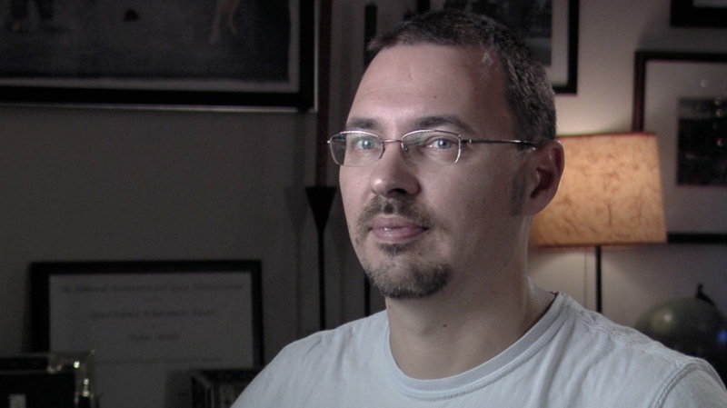

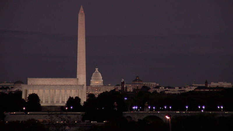

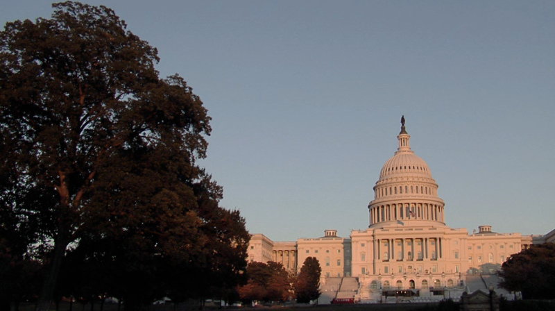

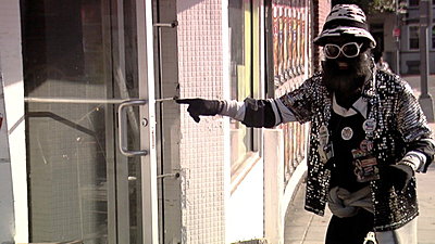

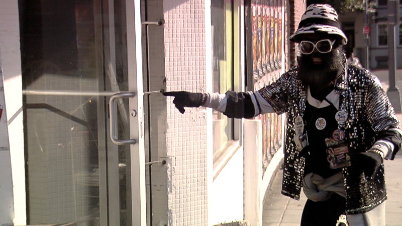

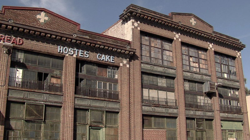

Thanks for your reply, Ryan. Below are some (unedited) frame grabs under various light conditions to illustrate what I mean.
- The interview shot using three 640W tungsten lights. The skin tone is off.
- The shot of the obelisk was during sun set.
- The capitol and brick stone building were shot in the late afternoon.
- The guy in the street was shot after noon (note the wall which should be white).
Do you think this could be due to IR leakage?

This is not to say this is your problem. I have run into a magenta artifact when there has been green spill from reflection or diffusion from vegetation in some of my shots when I whitebalanced to a white card in that environment then subsequently attempted to grade my colours.
You have trees in one of your locations. Did you manually whitebalance there or use the daylight preset?
I am prompted to this comment because the green in the trees appears to be suppressed.

I don't see any problems. shot of guy has white balance thats cool / cyanish... the other shots are a little warm, but look quite fine and certainly acceptable. I've noticed the camera can be on the warm side, but thats ok

Don't know where this stuff of yours is headed for final release, but if the Monument is a bit pink in the afternoon sun I can't see an audience getting up as one and exiting the cinema/ whatever.
I can see nothing wrong with any of the pics posted.
Geesh, you seen CSI Miami lately?
There isn't anything there remotely related to "real life" colour from the opening credits, and it's still up there at the top of the ratings.
By comparison, any isue with your pics is pretty small beer and can be put down to all sorts of oddities with time of day/ poor WB technique (the interviewee has a incandescent directly over his left shoulder - was that in frame for the WB or not?) etc etc etc.
