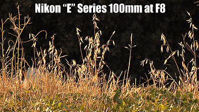

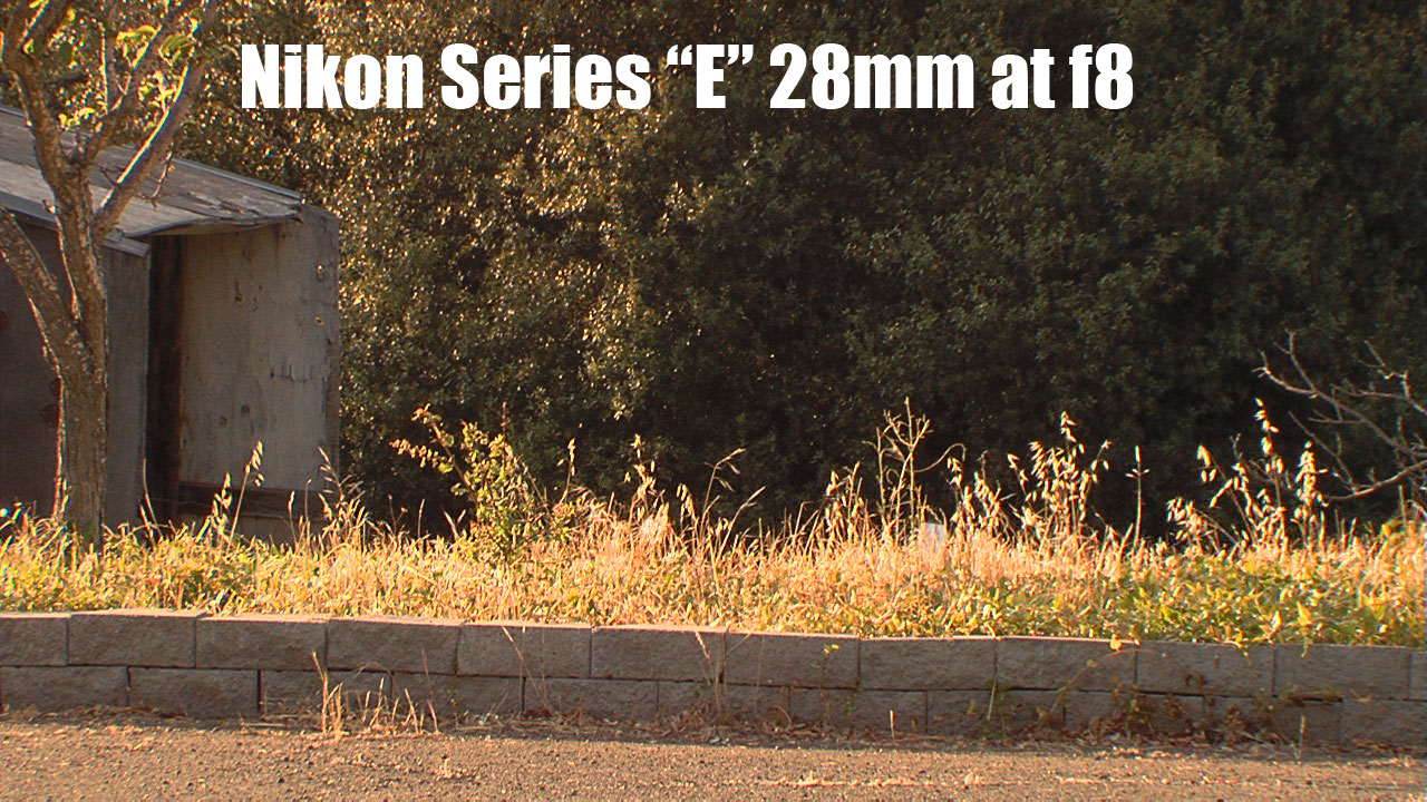

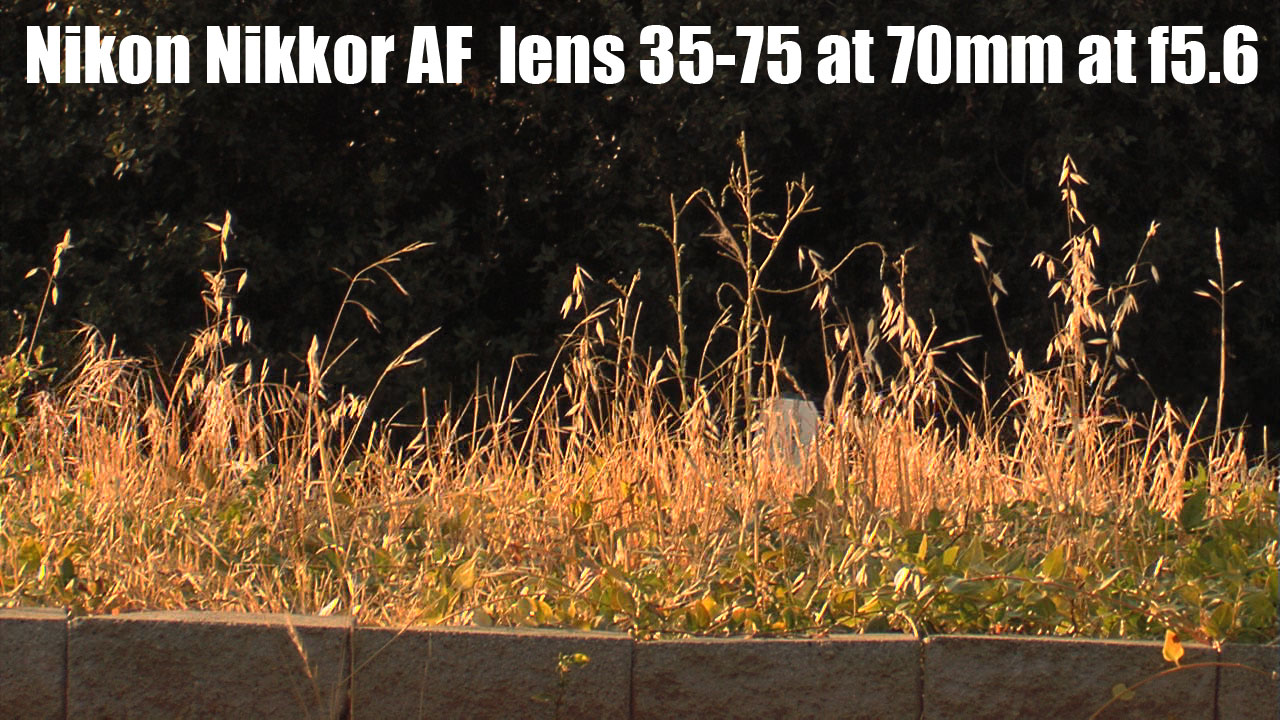

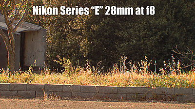

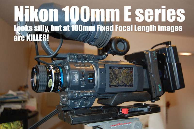

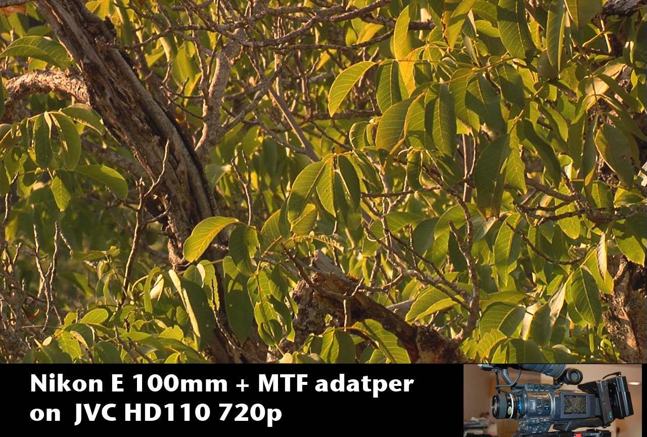

Well I just got my new MTF Nikon G adapter to JVC mount today and did some quick tests with my Nikon/Nikkor lenses. Results are MORE extreme thatn I imagined.
Short story as follows:
1 The old 10-20 year old manual focus lenses are BETTER than I dared hoped.

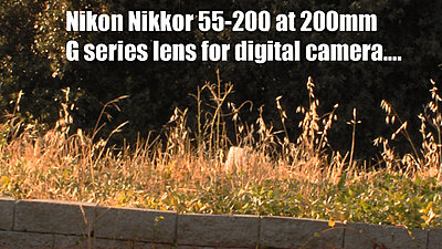

2. The newer (below $500) Nikkor DX Digital "G" lenses for the digital D40-D90 stock lenses where worse than I imagined.
These newer stock Nikkor lenses I already knew where not the top quality glass that Nikon is known for. For the race to the bottom for consumer electronics, much has been sacrified on these lenses. I saw vignetting in my digital camera from these new cheap lenses that shouldn't be called Nikkor or even Nikon lenses. So I didn't have much hope for them on the MTF adapter. I did get the MTF adapter for my manual focus lenses and any future 35mm used lens that MIGHT be for sale cheap that didn't have the aperture ring.
I tested some of my lenses before the sun set. I ranked them in this surprising order for the "BUY list"
1. Nikon "E" Series 100mm Manual Focus lens.. (not the Nikkor 105 that is far superior) was awsome. One would expect the better Nikkor 105 to be EVEN BETTER! But I don't have one to test.... Very Little CA except at full wide aperture. Great lens combo. Keep an eye out for used Nikon 100 or better yet the Nikkor 105.

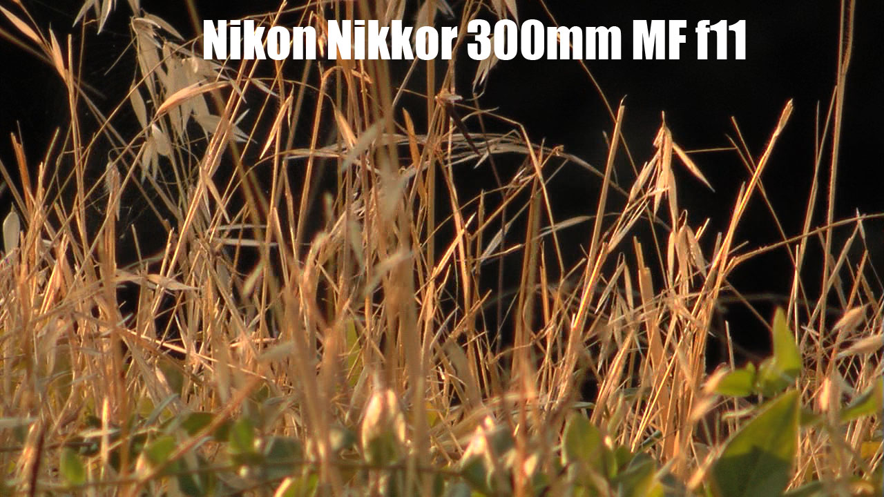

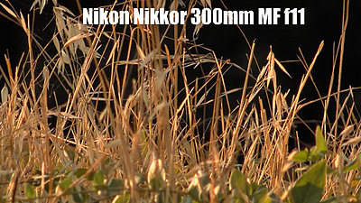

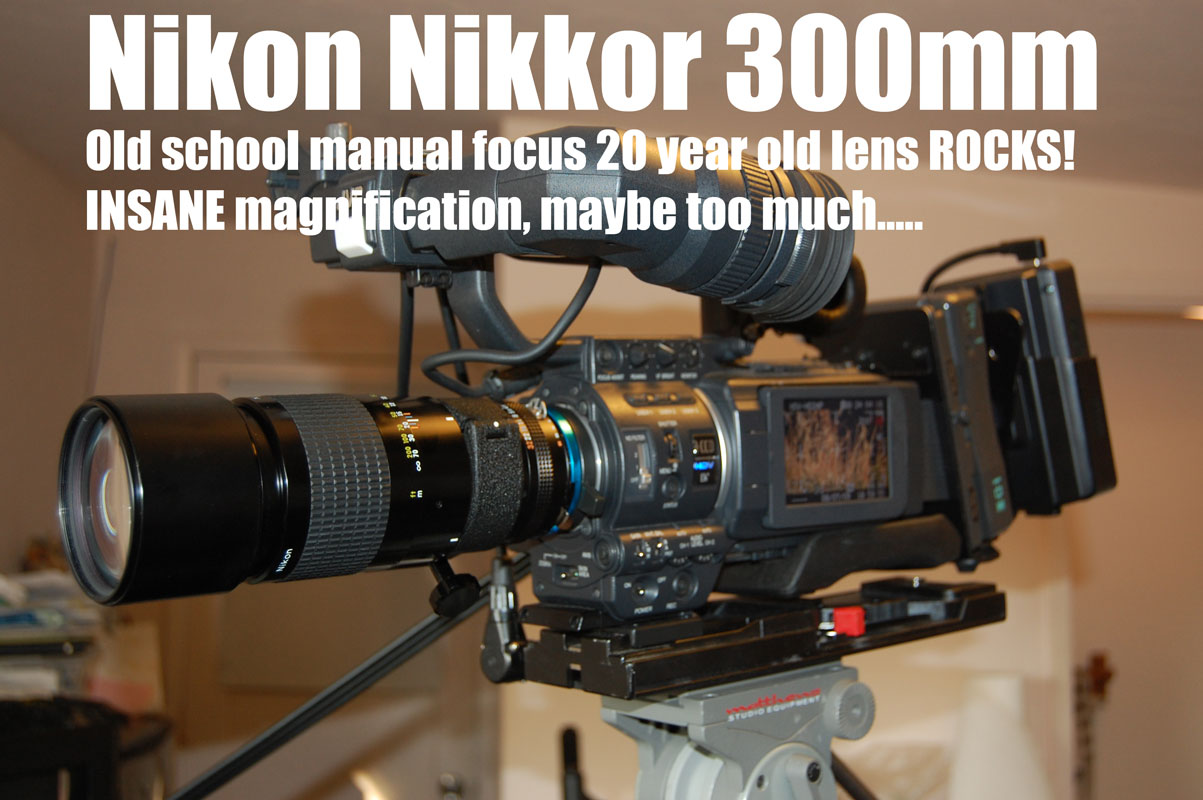

2. Nikon Nikkor 300mm Manual focus I had to stop it down to f11 to get rid of some CA in the really contrasty golden grass with the black background. It was obvsiously difficult to point at the subject I wanted and had to hunt a bit. It's like aiming your telescope with out a finder scope.
The other lenses I WOULDN'T get if you don't already have them, and DON'T waste your time or money on the Nikkor DX digital lenses under $300 AF lenses.
OK, moon should be rising soon, want to try the moon shots with the 100mm and 300mm tonight.

Well the don't have to be ANCIENT. Current manual focus lenses or used ones up to 20 years old. The better AF are probably fine.. But the test on the new consumer DX $300 and below Nikkor lenses are definatly NOT up to par.
I was actually astonished at how BAD the new 55-200 AF VR lens was even in the viewfinder. The answer is of course.. "What did you expect for $200?"
The most popular lens from what I hear for this set up is the Nikkor 80-200 2.8 AF or MF lenses. $1,200 new for the AF. Probably the most usefull range. I will have some fun with the moon setting on the ocean this month though with my 300mm Nikkor 4.5 though.... aiming at the moon is difficult.. I can only imagine trying to find wildlife in the frame let alone tracking one.....

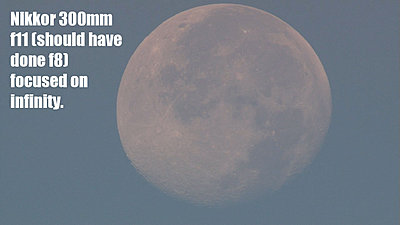

Just in case anyone wanted to know the FOV. Here is a thumb we all know.
Nikkor 300mm 4.5 MF lens at f11. I probably should have done it at f8, but oh well. Focused on infinity.

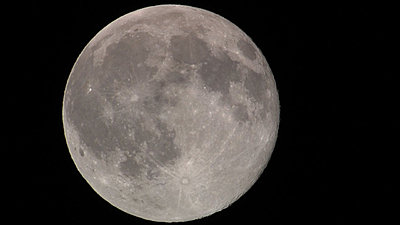

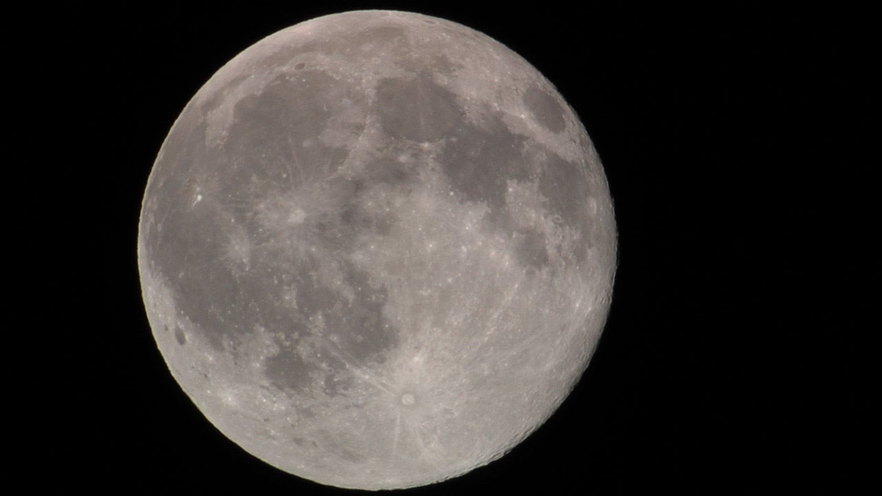

Well still doing 12 hour days, nearly midnight and I dragged the JVC HD110 outside, slapped the MTF adapter and the Nikkor 300mm.... just had to share.
Hmmm how do you white balance in moonlight?

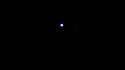

Rather obvious I admit. I noticed Jupiter was only about 30 degrees over, so I slewed my JVC over and got some of Jupiter. Finding Jupiter in the viewfinder was difficult with a 300mm MTF 1/3" CCD by the way.... anyway I could. I set the max gain at 12 and low and behold I got the four major moons of Jupiter as well. Jupiter has a lot of CA at the moment. Dialing down my aperture brought it back to normal, but the moons disapeard. Just thought I would share an ODD thing to do with a video camera. Maybe get to the coast Monday morning and watch the Moon set on the ocean with this lens. That actually I hope will be impressive.

That's awesome. Tycho and Copernicus are so clear... and that's only a 300mm! If you had a 1000mm I wonder if you could see what's leftover from the lunar landers? ;) Apparently there isn't a telescope on earth powerful enough to see them. http://www.tass-survey.org/richmond/...ar_lander.html
For those interested here's the identification of the mares and craters of the moon.
File:Moon names.jpg - Wikipedia, the free encyclopedia

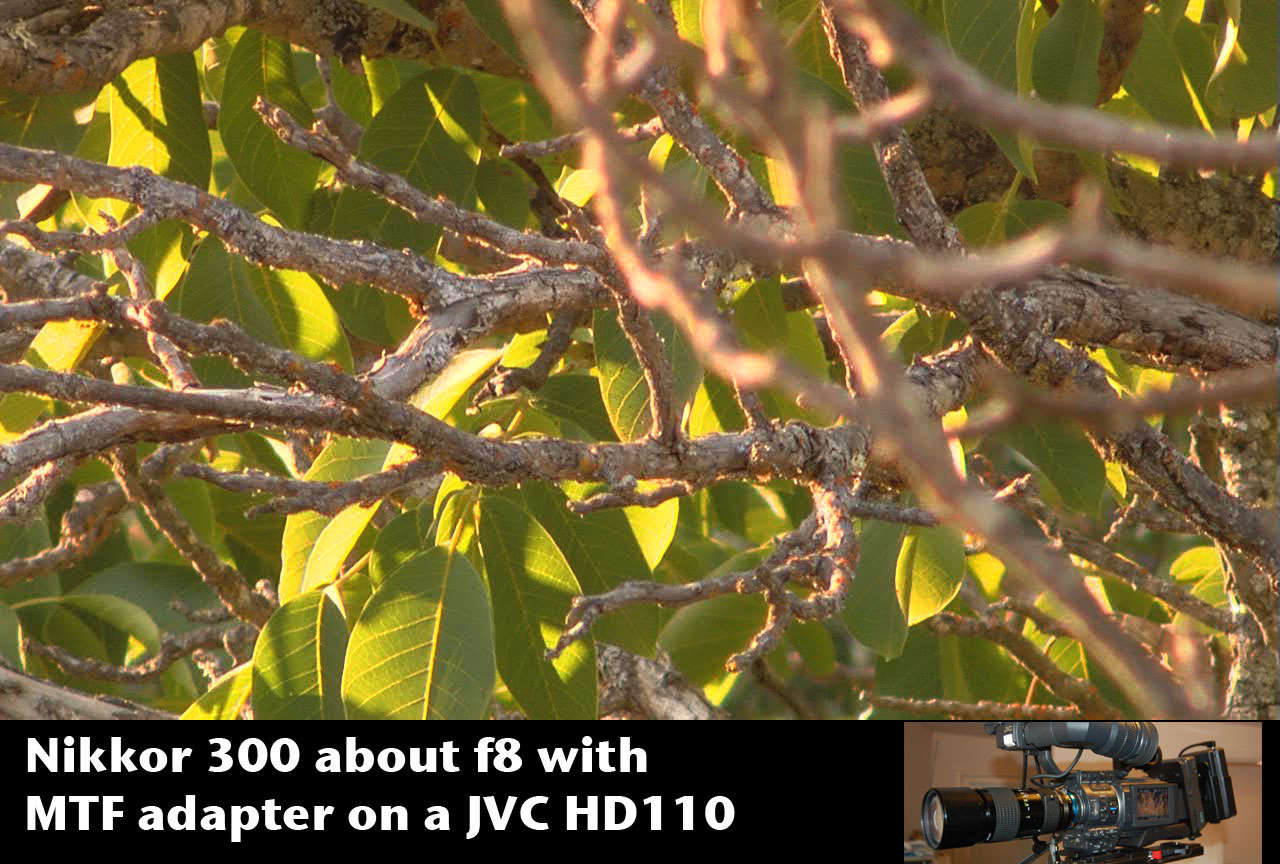

Thought I would add a couple new pics. ONly wish Nikon made a motorized lens so I could do sports with a Nikkor zoom. oh well, maybe have to still get a 17x Fujinon or maybe a 2/3 Fujinon and adapter rings. I still wonder if there is a good 2/3 lens that could compare with these. I don't know 2/3 lenses at all to know WHICH lenses to look at and which ones to avoid. (the 2/3 equivelant of the 16x entry lens I mean. )
In the mean time, here are some things I WISH my Fujinon 16x could do at 70mm or 80mm at f4. oh well.
MTF adatper and Nikon lenses, Good?  Depends upon lens.-nikone100tree.jpg   MTF adatper and Nikon lenses, Good?  Depends upon lens.-nikkor-300f8tree.jpg

think of the MTF option as an option for nature videography..... meaning 80-200mm focal length compared to the video lenses being 4.5 to 78mm or somewhere around there. I personally think the 100mm Nikon E is a nice lens, and if you have the money a 105 nikkor is a step up. thinking about a Nikkor 180mm next. The 300mm Nikkor (not sure if it's an ED or not) is less impressive optics, but still pretty good. Good for some wildlife video later this month I think.. or maybe get some surfing video in. Things like that. Not really for face shots and shallow depths of field, unless you can really put the person 30 from the camera and the background 100 feet away.
