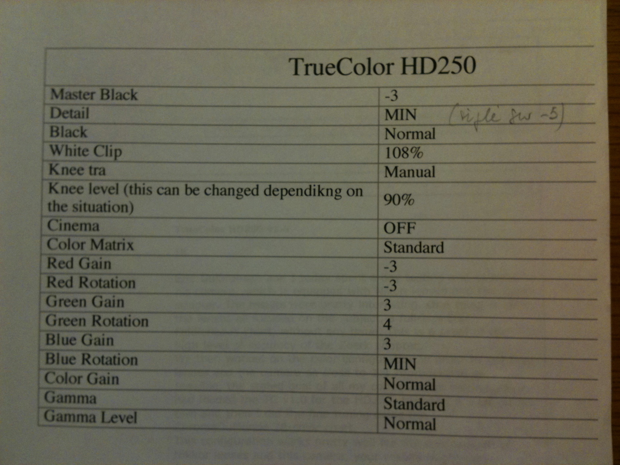

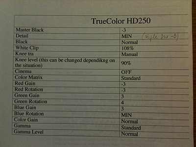

Here is the TrueColor250 file. Quality minimal as I quickly scanned it with my iPhone via Evernote. But the data are clear.

I presume that the settings posted above are without the adjustments to the red levels. I just did a quick test and found that the reds do pop. I wonder if it would be possible for either of you to post your finalised settings so I could try them out on my camera. I wouldn't ask normally but I'm afraid that I currently don't have access to a professional colour chart and can't play around with the settings myself.

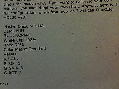

But I checked my files again and found this as well (a print-out from a post in this forum, date unknown). Again, apologies for poor scan quality.

Just checked my camera now and I think the only difference compared to the TruColour settings (the first one that Claude posted for the 250) is that the R Gain is set to MIN, instead of -3. Which seems to help a bit.
I also don't have access to a professional colour chart, unfortunately, so this change in setting is the best I've been able to do (but is the setting used for the two videos posted above...).

That does seem to pull the reds down a little. I'm going to have a proper play with the settings over the next few days.

The settings where spot on. I've been busy shooting over the last while as we develop the new project
