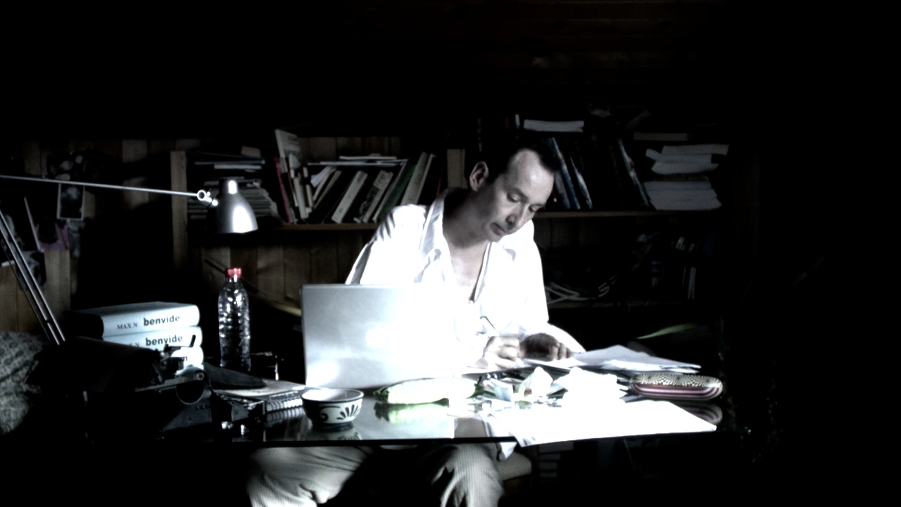

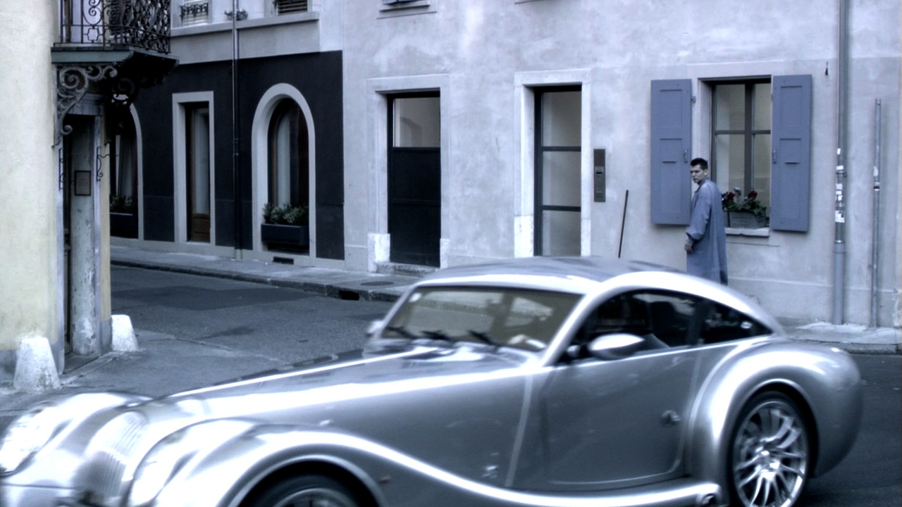

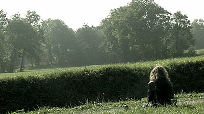

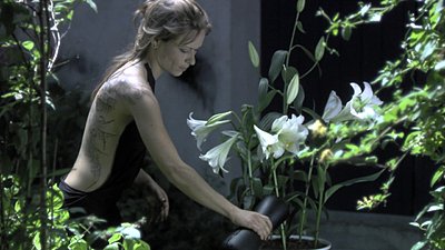

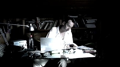

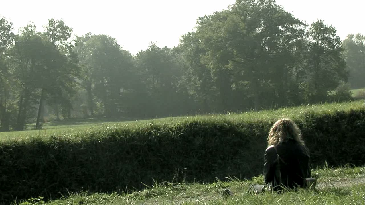

Below, a few stills from my recent shorts, all with that softness: Max, Mirko-Morgan and Jeunefemme frames were shot with Mini 35 & Leica resp. various Ultraspeeds and filters. Setting = Bleach Bypass with detail = min. VOIR with JVC adapter and Distagon, cam ND only, setting Superwide200, Detail -5.
But always striving to de better, especially managing the whites: soft burn is desired, but I'd love to be able to keep some detail nevertheless! Burned out («blinding», in creative terms) but still with some detail. A tough one for digital, so now experimenting. Would be interesting to know if you guys think that F3 and high-end cameras of th, F23, Alexa, Genesis type can do much better in this area. I am experimenting with film, also.
(I've mastered the same problem at the black bottom of the vectorscope with the 251 - being now able to keep detail in deep blacks thanks to small changes to Tim Dashwood's settings.)
Maybe Chis or Charles will comment ?

I observe in your landscape image with the hedge in foreground that there is a hint of something I found when trying to overstretch the SI2K image of a peach orchard, a sort of un-natural grey where there should be coloured shadows in greens.
I guess it could be called the expected outcome of image abuse, but personal foolishness makes me to try to know better than accomplished DPs and the camera manufacturers.
I found that subjectively, there seemed to be a nicer look to be had by using ND plus a Schneider Truecut IR filter. The greens and colours like dark purple-brown of ornamental plum foliage seemed to be more faithful. Please bear in mind that I am apparently partially colour blind and I am not using proper calibrated monitors so there are all manner of possibilities for things to be wrong with my observations.
With groundglass 35mm relay like the Mini35, I did experiment briefly with adding light to the groundglass from within the enclosure of a home-made AGUS35 adaptor.
It seemed to have an effect like the old technique of "pre-fogging" motion picture film or the visual effect of apparent expanded dyamic range when smoke of a campfire passes through a night image and background objects buried in black seem to become visible as a curtain of smoke passes.
I could not get uniform distribution of added light across my groundglass and because it was a spinning disk which was not running quite true, there was unacceptable flicker. I believe Dennis Woods (Cinevate) was also trying something similar at one point. It is rather moot now given the demise of 35mm groundglass relay adaptors.
I seem to recall hearing sometime that ARRI had developed some sort of active or light additive optical filter which was intended to function in a similar manner. Proper DPs would likely know of it and whether it worked or was a dead-end.
In meantime, for the aesthetic you seem to be after, my tendency might be towards experimenting with combinations of added ND, Truecut, Polarisers and finally Untracon filter, which itself seems to work a bit like the smoke effect. It seems to be able to pull up what seems to be about a quarter-stop of detail out of underlit areas, like stems of glasses and shadowed sides of trophies in back of a cabinet.
With added ND, the Truecut to keep the blacks true and unredded and your S16 lens irises opened up, there will be some more softening of areas not in focus. It is a bit like the obssessive quest for shallow depth-of-field with the smaller video formats which led to 35mm adaptors and 35mm format video cameras but for a different reason.
Again, hopefully Charles or Chris will comment soone or later and make good any misinformation my comments have inadventently generated.
I guess you are stuck with losing about one stop's worth of detail in whites in order to reach deeper into your blacks. I am way outside of my skill set here. All I can say is that for the brief period I had a play with the JVC, I muchly enjoyed what it could do for me.
