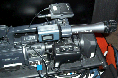

Phantom power must be off for the SM58 and the selector switch set to mic. I had a similar scenario when my shotgun mic died when I was shooting overseas. Instead I used my Sennheiser e835 mounted to the camera using my wireless SK100. That served as my shotgun for most of the shooting. Actually I liked the fact that I could pull the mic off and use it quickly in any situation.
Anyway, change your preamp selector switch to mic for a dynamic mic like SM58.

Here's the scenario:
