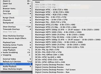

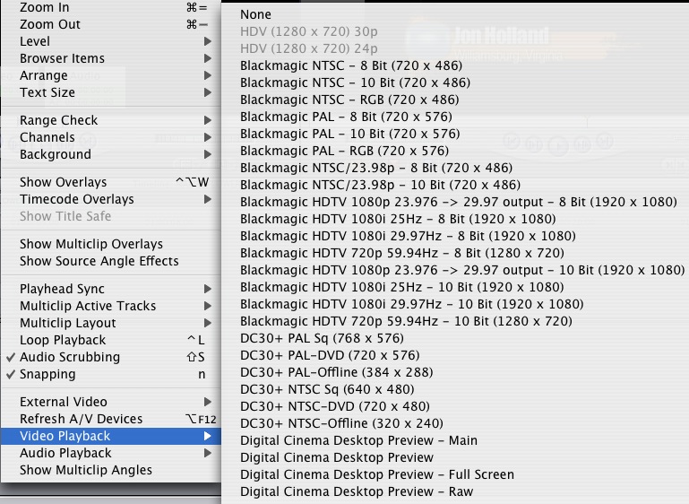

However, I could be wrong... and some new FCP5.1.2 greyed out options in the video playback menu might point to future compatibility with HDV live output. The screen grab below was taken when the HD100 was connected. The firmware update in the BR-HD50 might unlock these HDV options.

As far as your screen grab...wow, I don't get anything that looks like that. I only get four options: None, the two grayed out HDV, and digital cinema desktop preview -main. I guess the update did not make the grayed out options available.
