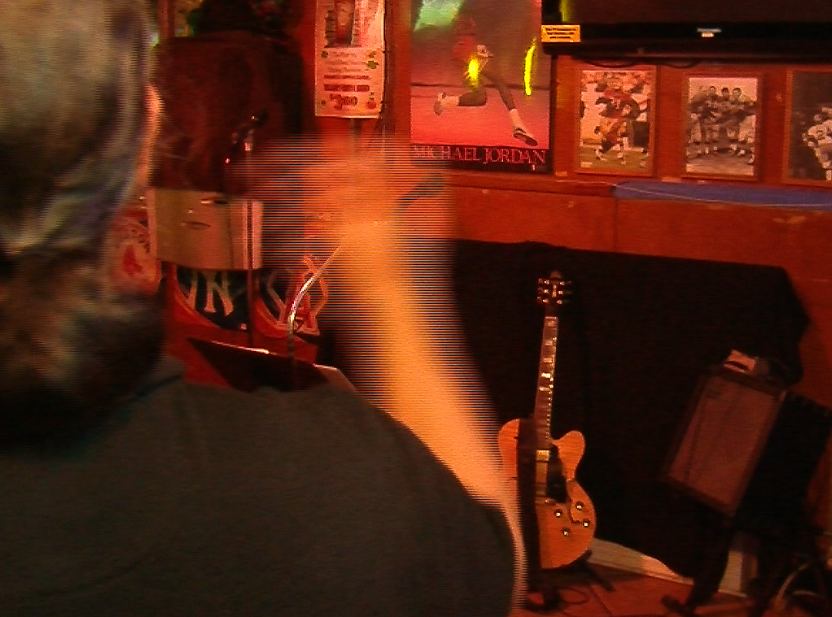

I just had the same thing happen to me the other night. It was a band performance in a bar and I thought it might have something to do the shutter interaction with the neon light that was in the window and sending some light to the scene, although it didn't make too much sense.
Unique camera parameters about this shoot:
The lighting there was abysmal, so I had the camcorder on high gain (9 or 18 db) , and in 1080 30P aperture wide open with a 1/30th shutter speed. I usually tape in 1/60 second shutter speed or faster. On other thing unique about this shoot is that I had the camcorder plugged into the AC/DC power supply, so I wouldn't have to worry about changing batteries during the 3.5 hour shoot.
This glitch remained on about 3 hours of HM100 video I shot that night over the span of about 15 files, it didn't come and go as others have mentioned. (used file/card spanning, I turned off record only a few times during breaks. The spanning didn't work quite as reliably as expected, maybe I'll address that into a different forum post.
The recording was not critical, or I would have cared a bit more and tried to correct the problem in post, but as it was it was just for feedback for the band and for a SD DVD to give the band.
Looking at this forum thread it makes sense that there is some bug that is causing this. I did a more important shoot the following morning and it seems everything was recorded normally (I had it mostly in "Auto").
Does it have to do with gain, shutter speed, AC power, or is it some random thing? Also the problem is you really can't tell anything is wrong with the LCD. I looked at the original clips directly from the HM100 through an HDMI port and I can't see interlacing like I can when playing the files via FCP or Quicktime. Maybe the problem a glitch in the file information that the HM100 writes and that QT uses, I don't know. All I know is that playing clips that appear to be recording in the same format, on my Mac with 10.5.7 this particular night's 1080 30P files had this problem.
I tried seeing if putting the clip into a XDCAM EX 60i timeline to see if I could fix it, and it didn't for me. It looks like the interlacing is embedded into progressive video, there's no way to 'deinterlace it.' so the footage is junk. It seems that the problem is not just that you have interlaced instead of progressive, it's that you have interlaced footage put into progressive frames. You can't fix it in post. If you had an important shoot with a lot of movement, you'd be screwed.
I'm just hoping this is an isolated incident. I haven't closely looked at all the previous footage I've shot with the HM100. I think most of it is OK though, but I'm not certain.
Attached is a screen capture of an area of an arm moving which clearly shows the interlacing (this was from my FCP canvas window, and not the whole frame)
So Tim, JVC or others, if you are listening, please, please investigate. If you want I can upload some files to one of your FTP sites so you can investigate further.
