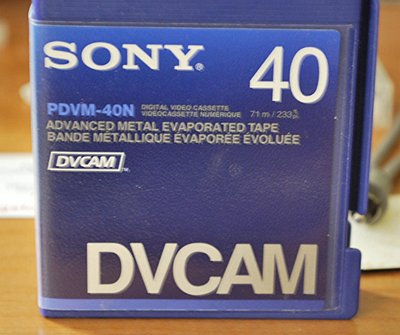

Ok, found a 40 minute DVCam tape (PDV series) which is a 60 minute DV load and lo and behold:
233 feet as printed on the label.

Here's "proof"
Shaun C. Roemich Freelance Video Professional - Vancouver, BC
"Telling your stories since 1999" www.gearheadvisual.com

ACTUALLY ALL MY FAULT: last night I grabbed a large cassette 94 minute.
The PDV-184 (4.5 hours in DV) is 1033 feet)
Apologies for the misinformation. No more typing just before bed.
