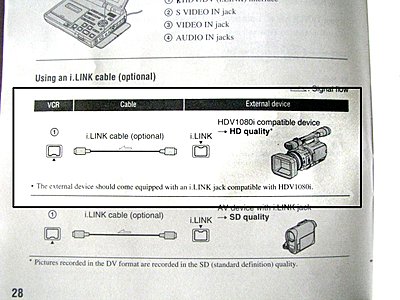

The specs on B&H site, in fact, only say hdv playback, but I am quite sure we have hooked two decks together and duped HDV camera tapes via firewire....let me dig out my manual, I'll get back to you on this. Wouldn't want to mislead you, I will check. / Battle Vaughan
OK, page 28 of the manual specifically shows a recording hookup from a camera to the recorder as "HD 1080i compatable device > HD quality" via the iLink (firewire) cable. It doesn't support 720P or 24p or any other format of hdv. This is in the section "Recording the picture from tv, vcr, etc." So you can hook up a camera to it if you want. This demonstrates that it does, in fact, record hdv.
I have not tried exporting to tape from Final Cut but can't see why it wouldn't work as the ingest function works fine, we do this every day.
To answer the last part of your question, we have used these for about 2 years with a variety of semi-trained people, and (knock on wood) have never had a problem with any of the 5 we have. If these guys can't break it, it probably is a brick.....as to field use, I bought my own, as I have to log pool video from courtrooms, commission meetings, exciting stuff like that, and like to have one in my kit. So far, never failed. /bv

Outstanding. Thanks so much for the reply.... you have helped me make up my mind!
I'm gonna go with this.
