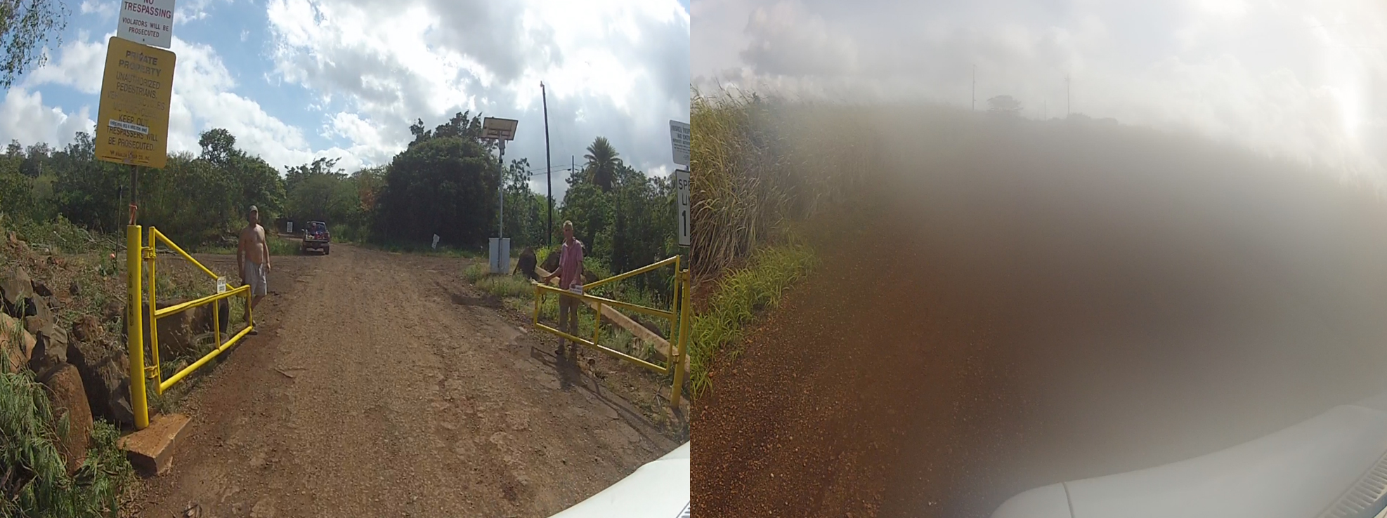

I also had issues with the dome fogging up from the inside here in humid Hawaii. I had a GoPro2 mounted on the front of my van. I was documenting the roadway on a farm. The shoot was about an hour long. As I drove, the camera heated up and fogged the inside of the dome. I had the skeleton back on, and didn't think it would fog up with the wind blowing through, but it sure did! When I saw that it was fogging up, I took the camera out and blew on the inside of the dome, which dissipated the moisture. I put the camera back in, and continued to shoot but it fogged up again!
On another shoot, I had the GoPro2 indoors, on a tall light stand. The heat of the camera again caused fogging on the inside of the dome with the skeleton back. It definitely was not lens flare as I could see the fog getting worse and worse by the minute! Attached are before and after photos. My remedy now is to shoot without the housing if possible. I put a small strip of adhesive-backed velcro on top and bottom of the camera, and use those as mounting points.

I'm sad to say that your images and mine from the wedding on Saturday look very similar!! I have an idea that mine is not flare but indeed fogging too!!! The previous Saturday I did a rainy wedding, but indoors and the footage was perfect..but last Saturday it was overcast and quite humid (it had been raining in the morning) and my footage looked like flare on the right top corner as there was a river behind the ceremony but as the ceremony progressed it now does look like fogging!!!

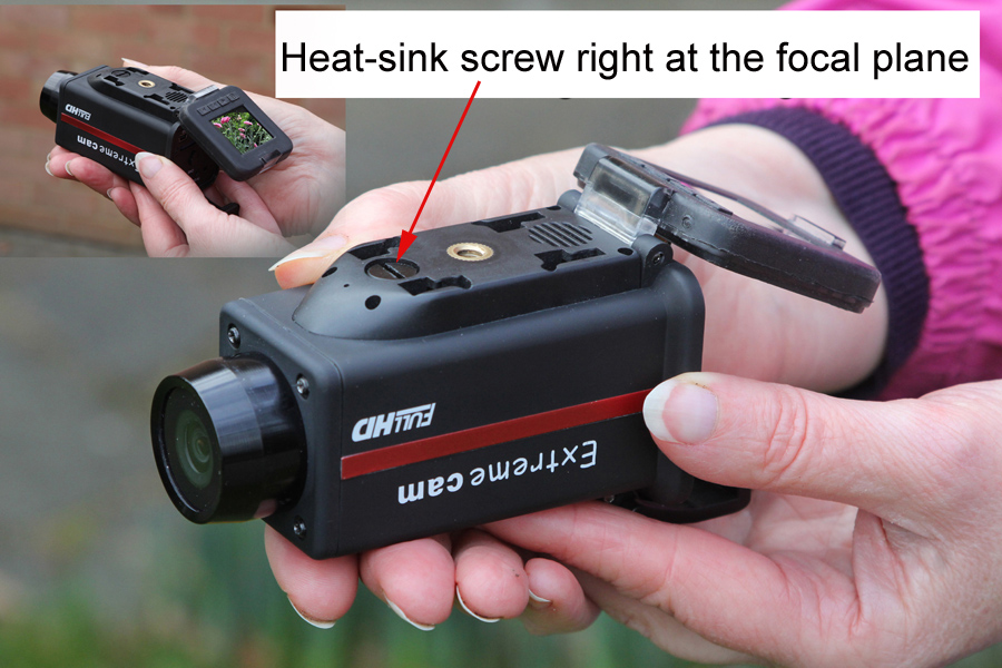

My Extreme cam is waterproof without the need for an external housing, though it uses a big-headed screw as its CMOS heat-sink. Never had misting problems with its little protective front glass.

Yes, I've seen condensation form in the front dome. It will begin as a little patch, then grow until almost the entire glass area is covered. Even with the skeleton back on, I'm guessing that the camera fits so tightly into the housing that the dome area cannot air out. Hence, the fog!
