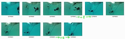

If there is good overhead lighting it works ok, but any shadows will be slightly noisy and bright/dark variations can trick the white balance. Do use a flat lens (either Gopros new one or aftermarket) or focus will be very soft.
This was an indoor dive pool good lights but white balance shifted.

So, I'm curious have more people experienced such rapid whitebalanceshifts during a take?
Or does it only happen with pictures?
