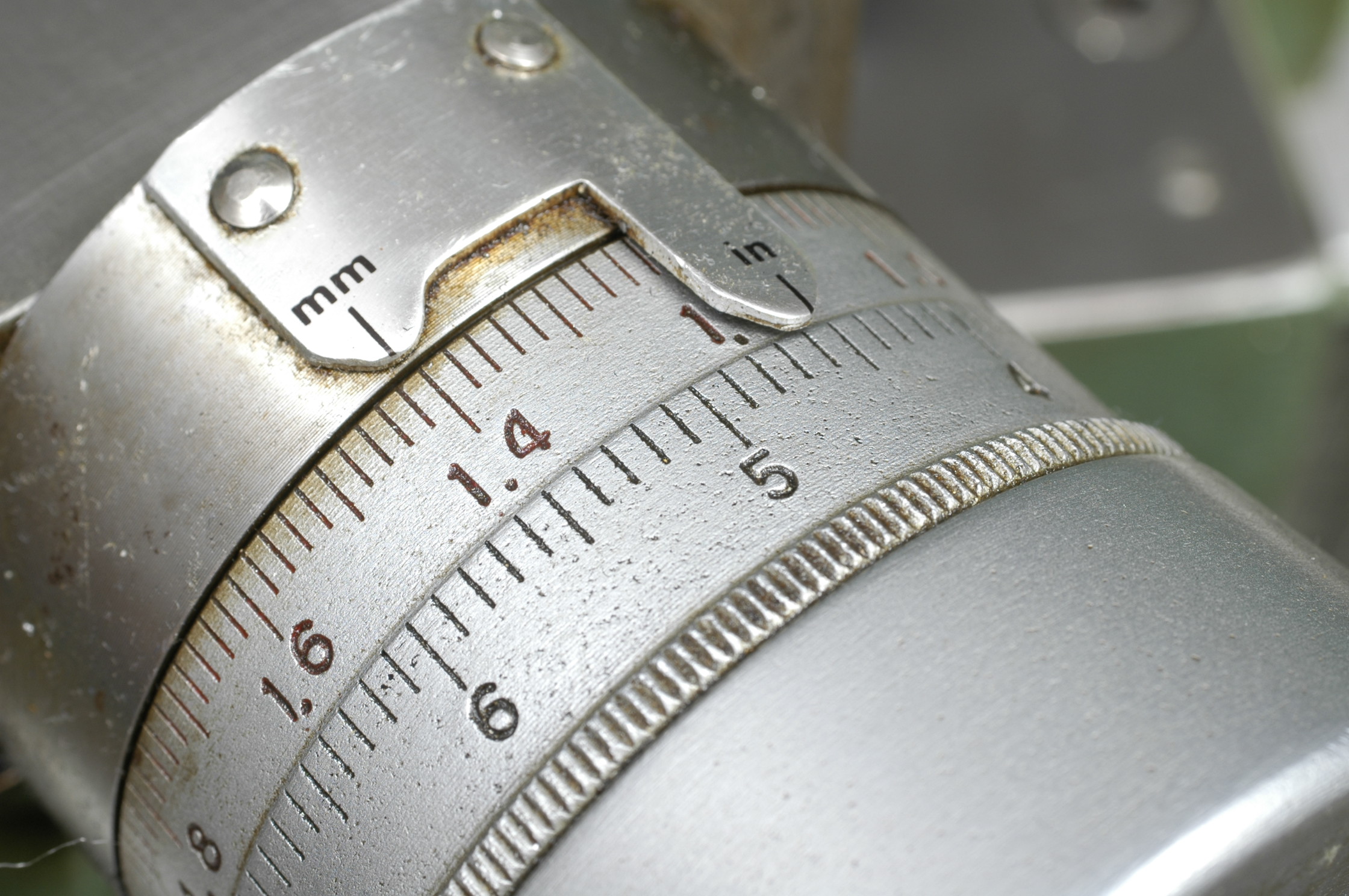

Probably too late to be of help, but: Sigma 50mm macro is a very nice lens at a comfortable price. (Sample image attached)
Most macros go to 1:1 ratio, which is not enough for your needs. And their optics are often recessed in the mount, which means that the mount makes it difficult to physically get close enough to the subject.
Takes a little work, if you are handy, but I once made a t-mount to leica-enlarger-thread adapter by simply drilling and tapping the t-mount and mounting a standard enlarger-lens flange to the t-mount. Coupled with extension tubes or a bellows, a 50mm or shorter Leica-thread enlarging lens could be made to make enlargements much greater than 1:1, and the lens construction allowed it to work close the the subject.
I even mounted a 75mm lens on an 8x10 view camera and made extreme closeups with that, but that's another story.
Also -- your mention of long exposures. Remember you need a small f-stop to get any depth of field,and light falls off as the square of the distance, lens to sensor. So your 4:1 enlargement of a 1/4" object would lose, if I recall correctly, 4 stops of light. (somebody check me on this?) At any rate, it takes solid mounting and long exposure or a LOT of light to do what you want. Best wishes!
