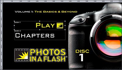

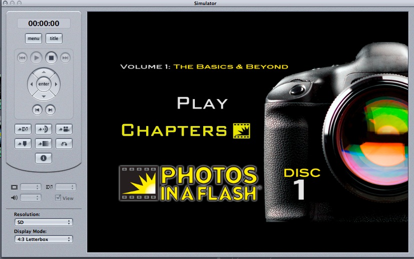

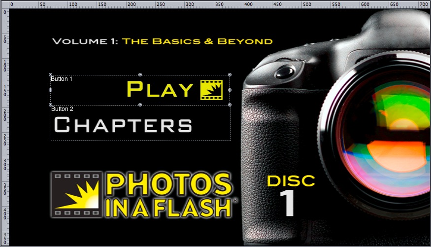

No, big Hollywood studios are using Scenarist or Blu-Print. Both apps cost over $150K just for a single-seat after licensing issues are paid up-front.
Encore is somewhere between iDVD and DVDSP4 in it's overall functionality and is not used by any pro post-houses that I'm aware of. It's a good app and does it's job well, just not as developed as DVDSP. Although Adobe did one-up Apple by bringing in native BR support (burned discs only, not for replication).
Not sure why you're having such trouble with your images and text; if you're not building a motion-menu your results even in the online preview (simulate menu) shouldn't be any worse than these examples:
You're not zooming-in on the simulated menus, are you? That will definitely show stair-stepping edges.
Use of images in DVD Studio Pro (4)-picture-1.jpg   Use of images in DVD Studio Pro (4)-picture-2.jpg

Hi Robert - no zoom ins. Just a simple import of an image graphic (in this case a 1024x576 tiff to slot into a 16:9 production). I'm always aware that small text in video and red are pretty much a no no but in this case they have been avoided. I've never had any trouble with the templates and they've always looked good on a television. I will try and post up an example - very busy at the moment so it might be a day or two, but it might be worth showing.
