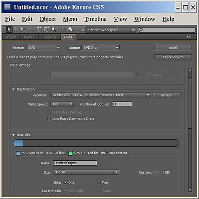

From the Encore Help files at:
Adobe Encore CS5 * Determining disc size
Dual-sided disc
For dual-sided DVDs, you must create two separate projects. If you will replicate the DVDs at an outside facility, use the DVD Master output option to write each project to its own DLT.
Also:
Disc Info ...
For DVD output, Disc Info also includes the following settings:...
...Side Select One or Two to specify the side of a dual-sided DVD. (For more information, see Determining disc size.)
at Adobe Encore CS5 * Building the finished project
and
By setting the disc size for your DVD project at the beginning of the authoring process, Encore can calculate how much space is used for each asset you add to the project and how much space remains free.
1.Choose Window > Build.
2.In the Build panel, choose DVD from the Format menu, and scroll down to the Disc Info section.
3.Choose a size from the Size menu. To enter a custom disc size, choose Custom and then type a size in the text box.
4.If you want to create a dual-sided disc, specify which side this project is for.
5.Close the Build panel and save the project.
at
http://help.adobe.com/en_US/encore/c...C7AFAE03a.html
Admittedly, not what you'd call comprehensive but maybe enough to get you pointed in the right direction.

Originally Posted by John Gerard View Post
The bottom line is that it looks like Encore will not split one project into 2 projects.
As it says above, it won't. You have to create two separate projects.
But I don't know how to tell Encore to put it on a separate DVD without creating another separate Encore project.
As it says above, you can't. You have to create two separate projects.
I also was not sure how to specify which time line was project one, side 1 and which time line was project #2, side 2.
As it says above, you don't. You have to create two separate projects.
It's not that hard. Set your work area bar in Premiere to cover part one, then export to Encore. Then re-set the Work Area Bar to cover part two and do it again.
But it's so much easier to do a dual-layer disc than two-sided. Encore makes the layer break for you if you tell it to. But look at the bottom of the graphic below -- that's where you specify the side on a dual-sided disc.
