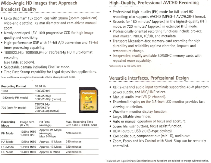

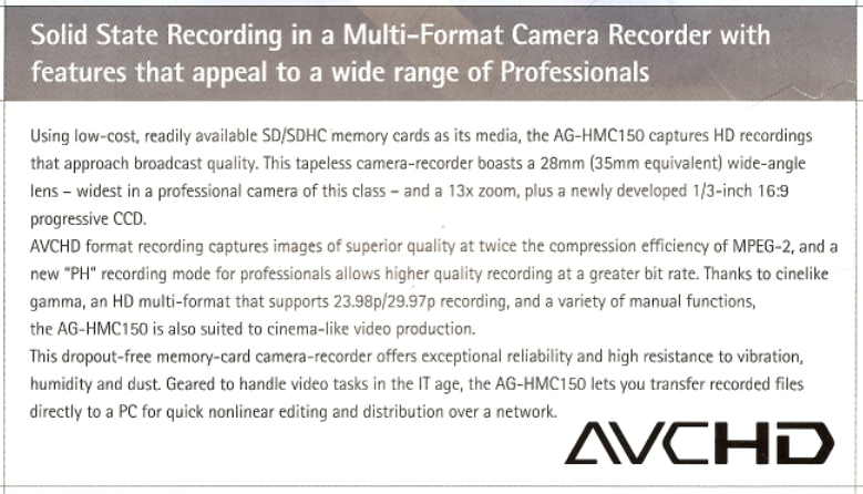

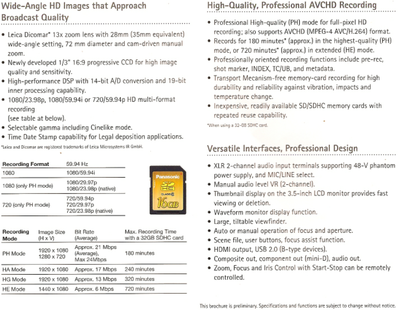

I'll try to attach photos of the copy of the early specification sheet from Panasonic on the HMC-150. I only scanned in the key parts...

Old July 4th, 2008, 08:57 AM   #27
Location: Houma, La.
Posts: 1,253
Images: 5
I really like what I see out of those specs. Here's some food for thought:
32GB of 21Mbps AVCHD storage (SDHC class 6 card) will cost you $430
32GB of P2 storage will cost you $1500
1920 x 1080 and 1280 x 720 take up the same amount of space on the card according to the chart. Why is this?
It shoots 29.97p and 23.98p (native) which is good, but I don't see 29.97i listed. Does this mean no 1080i? Or does it mean 1080i but only at 59.94? I'm confused. Not that I'm a huge fan of 1080i, but some people might want to mix and match with their 1080i HDV cams and this would make it easier.
Overall, this thing seems impressive on the surface. I can't wait to see some footage from it, especially in low light since I do weddings. I've been hoping this is the camera I've been waiting for, in the price range I need it to be in. I can't afford an EX1 or camera in that range.

Old July 4th, 2008, 10:29 AM   #28
Location: LA, California
Posts: 116
I can understand 1920x1080/30p and 1280x720/60p taking up about the same amount of space on the card, but you would think that 1280x720/30p and 1280x720/24p would take up less space.
Either:
(1) This is just a mistake on the early flier for the HMC-150.
.......OR
(2) Both 1280x720/30p and 1280x720/24p have much lower compression ratios than 1920x1080/30p.
IF it's case 2, then the 1280x720/30p (& 24p) have a higher bit rate than the JVC's HDV video (19 Mbps). In that case, the compression noise would be a lot lower than HDV.
If you look closely at the specification, every mode has to be at the maximum data rate, except the 1080/60i. See Recording Format. The 1080/60i can be at the maximum data rate, but can also be lower. Not that I'd ever want to record at a lower data rate.
DV Expo West comes to the LA area in early November and I can't wait to check out the HMC-150. It should be shipping by them, so this will be the final product and not hte prototype.
