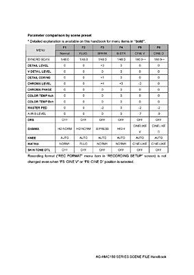

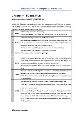

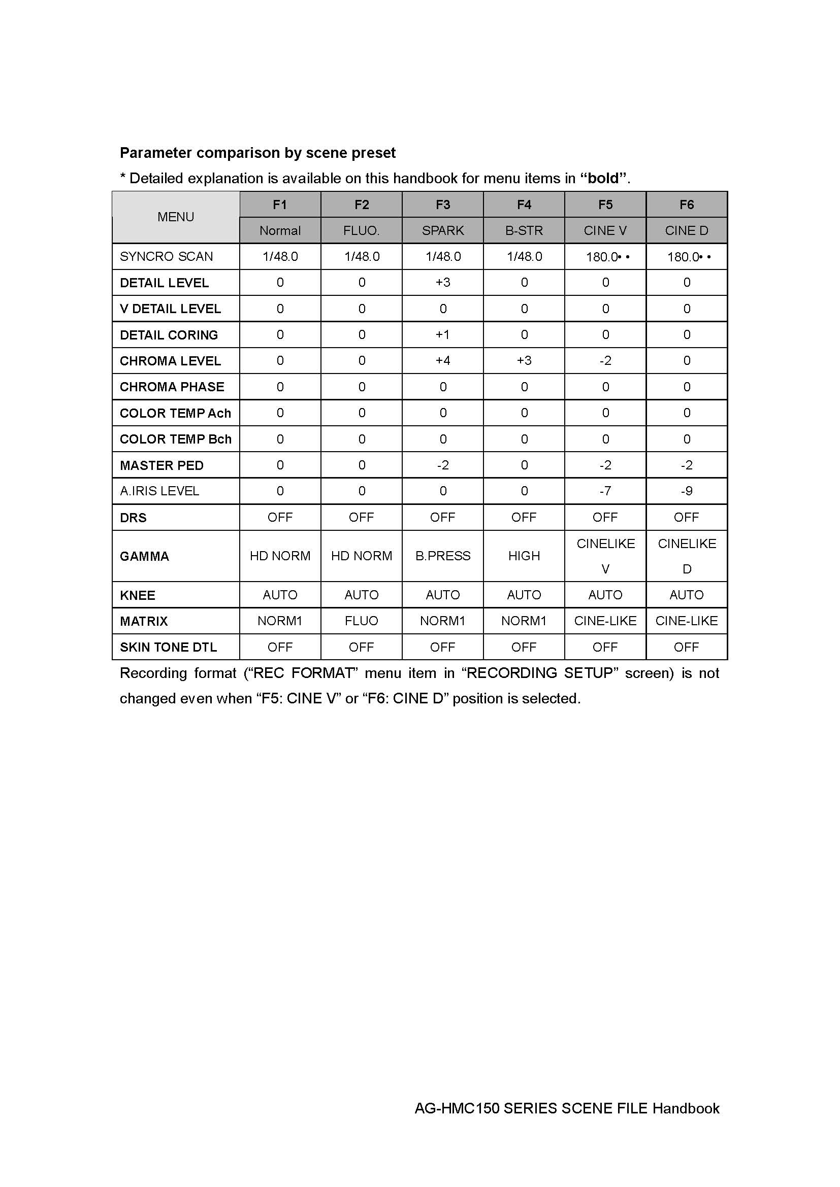

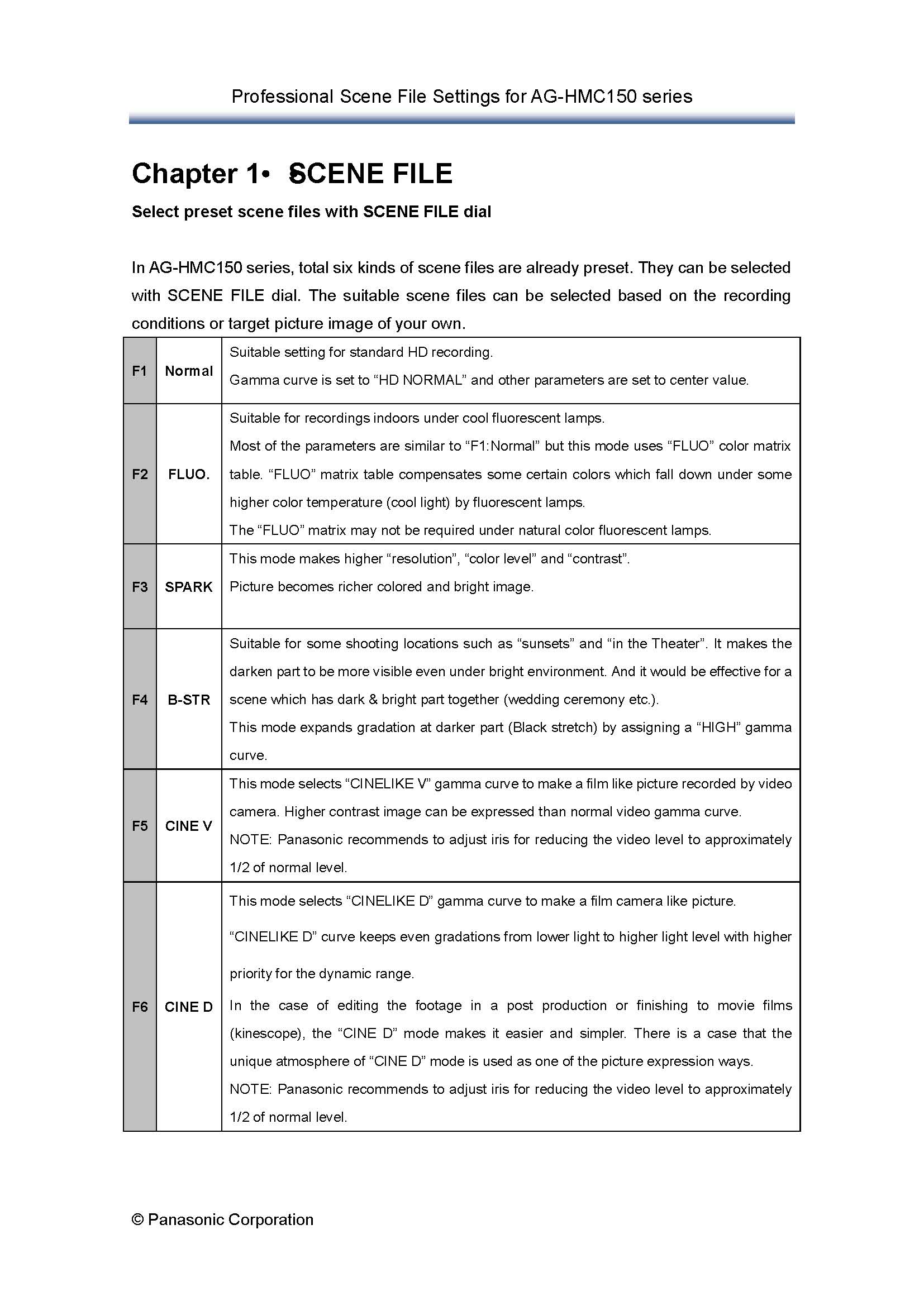

The 6 HMC-150 Factory Scene files
This is the Panasonic factory information describing the 6 factory set up scene file settings. The original PDF file is also attached.
