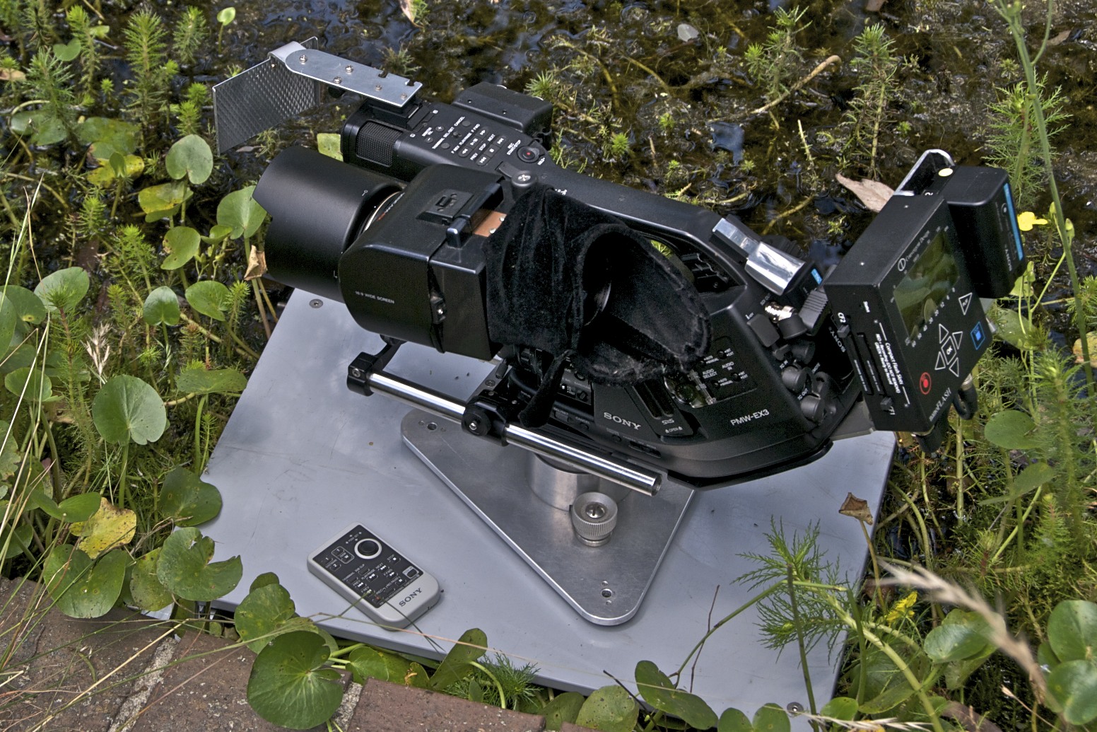

As a matter of interest foil reflector for the EX3 now slides into the front accessory shoe.
http://www.dvinfo.net/forum/attachme...1&d=1298289978
