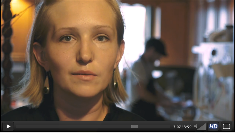

Nice indoor stuff. Was all that indoor shooting of the catering just with available light?
How's the Bokeh when you are about 4' from the subject at 54mm? Any ideas what focal length, aperture and ISO you were using on the attached?
I'm reading different things about the feasibility/reality of the rumored 12-75.
Anyone using the Olympus / Zuiko Digital 14-54mm F2.8-3.5II on a GH1?-screen-shot-2010-10-06-8.32.08-pm.png

Bokeh's fine - that headshot you posted is about four feet away and maybe in the 35-40mm range IIRC. Not sure on the specs of the shot of that headshot, but I was probably fully open, 1/50th, and in the 600-800 range.
All videos on there are with available light (though on the red carpet of the Project Twenty1 video someone set up a softbox)

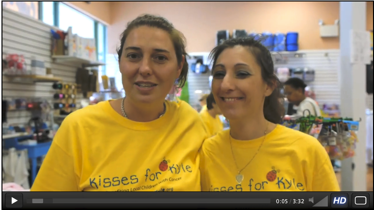

I noticed in the Kisses for Kyle piece, the Bokeh was much less. Is this simply the wider FOV or could you have opened the aperture some more?
Can you recommend a useful level of ND for sunny outdoor shooting?

Forgot to attach the Kisses for Kyle example.
Anyone using the Olympus / Zuiko Digital 14-54mm F2.8-3.5II on a GH1?-screen-shot-2010-10-07-8.37.08-am.png

Les Wilson I noticed in the Kisses for Kyle piece, the Bokeh was much less. Is this simply the wider FOV or could you have opened the aperture some more?
Have you used the 20mm f1.7 pancake?
The bokeh was less for two reasons - it was indoors, yes, but on a bright sunny day with windows, so the aperture probably was closed down a bit, maybe 4.0 (which I usually aim for vs. 2.8 if there's enough light). It is of course a wider shot since there's two people - I zoom in for a close up in that vid you'll see so the zoom is probably halfway for that shot you posted.
