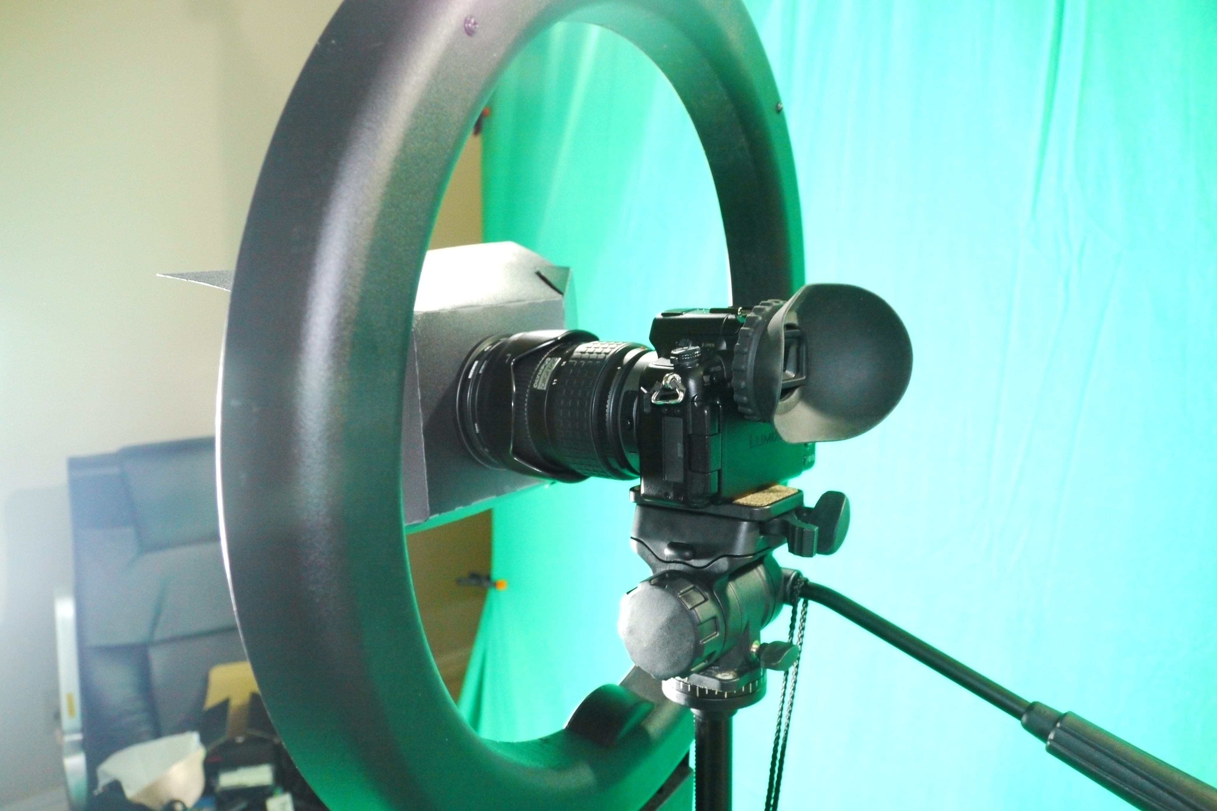

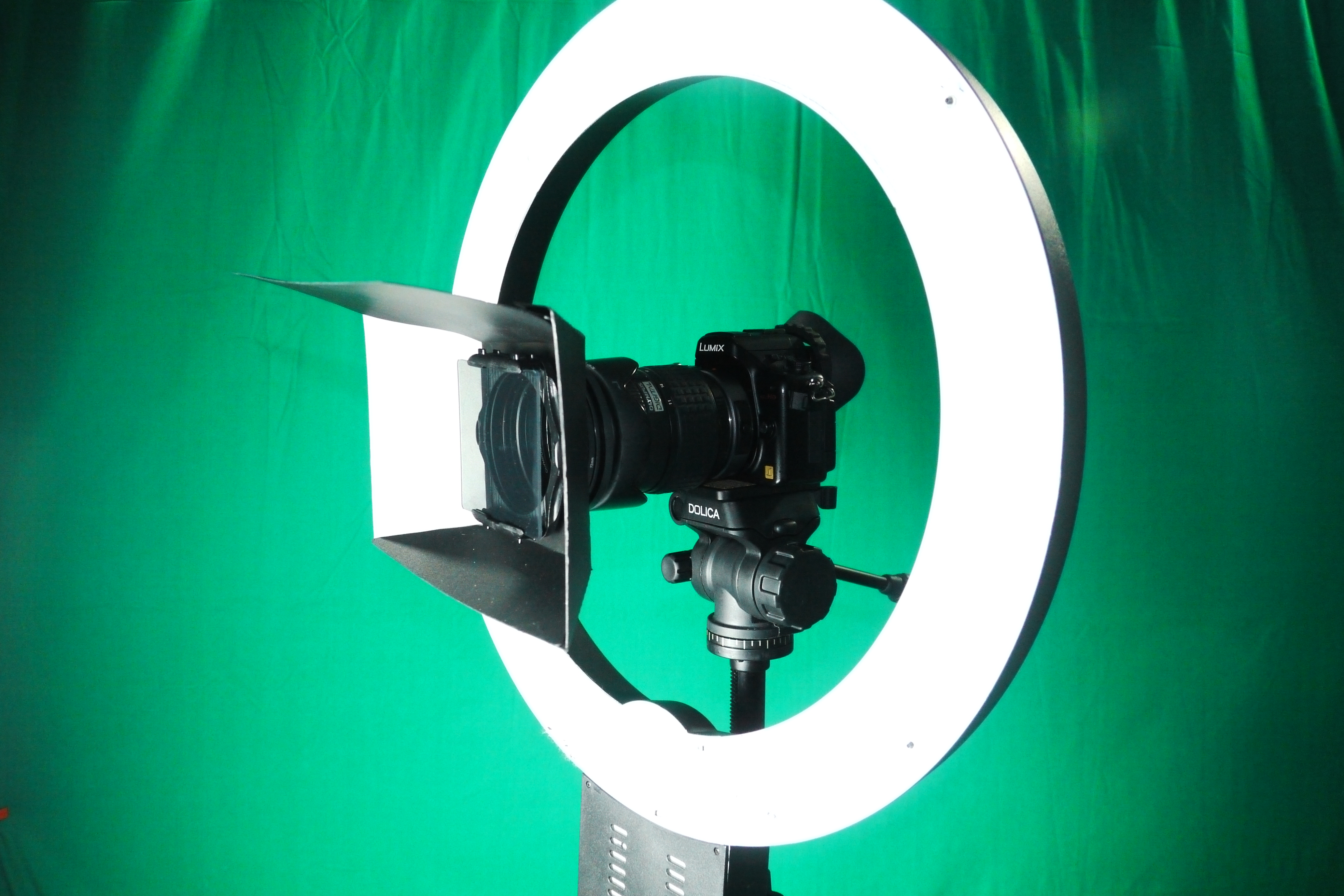

A couple of pictures of the matte box on the GH2 are attached. There is an
in one of the slots.

How to get "this" look on GH2 video-p1010602.jpg   How to get "this" look on GH2 video-p1010603.jpg
